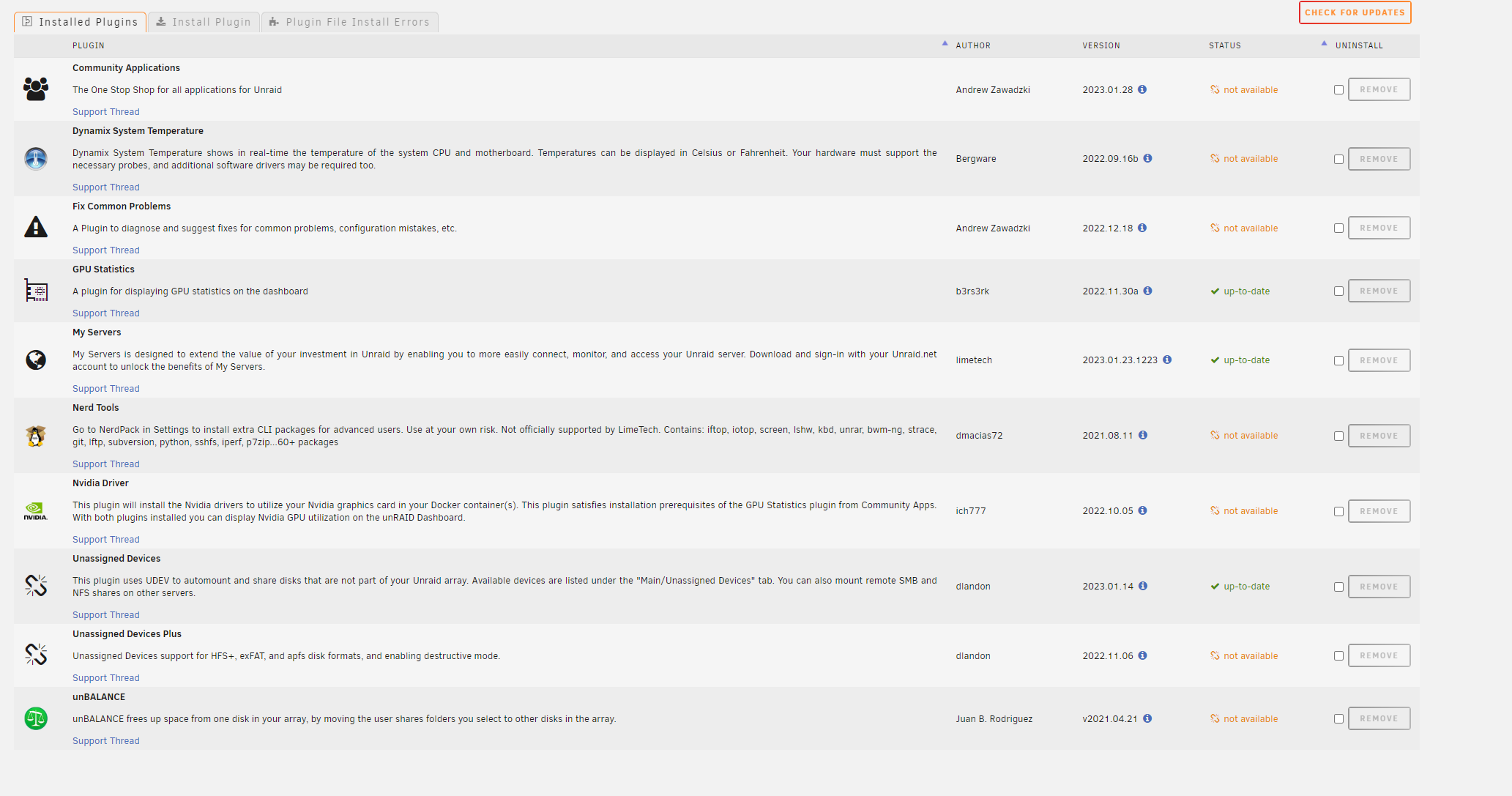

Hello,
I am having a weird issue for the last couple of days. My Plugins do not update and even checking for updates causes the Status to  change to "Not Available"
If I try to manually install I get a Network Failure error but Docker updates fine, nothing has changed I am running 6.11.5.

Whenever I try to install a plugin I get Network Failure, all other things work. Dockers update fine just plugins are broken
I believe I have a govt issue, I can ping raw.githubusercontent.com and github.com but somehow cannot connect via SSL.
I tried changing DNS to OpenDNS but my govt uses SNI blocking so changing DNS does not help. I can use Dockers fine only Plugins are failing.
