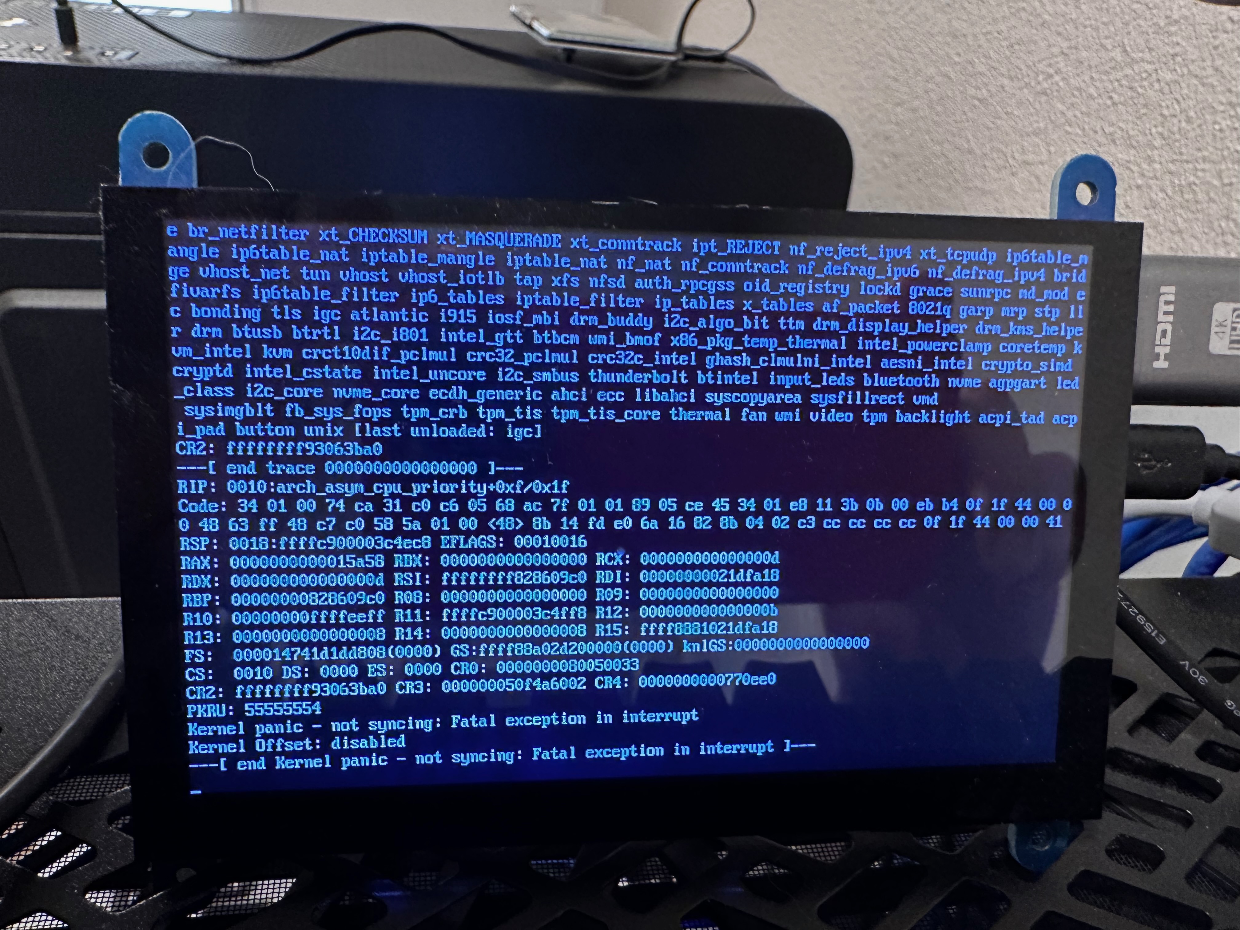

Here is a picture of a small HDMI monitor I have attached while I had this command running. My hope was I'd catch an error in the act and get something useful.
tail -f /var/log/syslog
This means little to me.

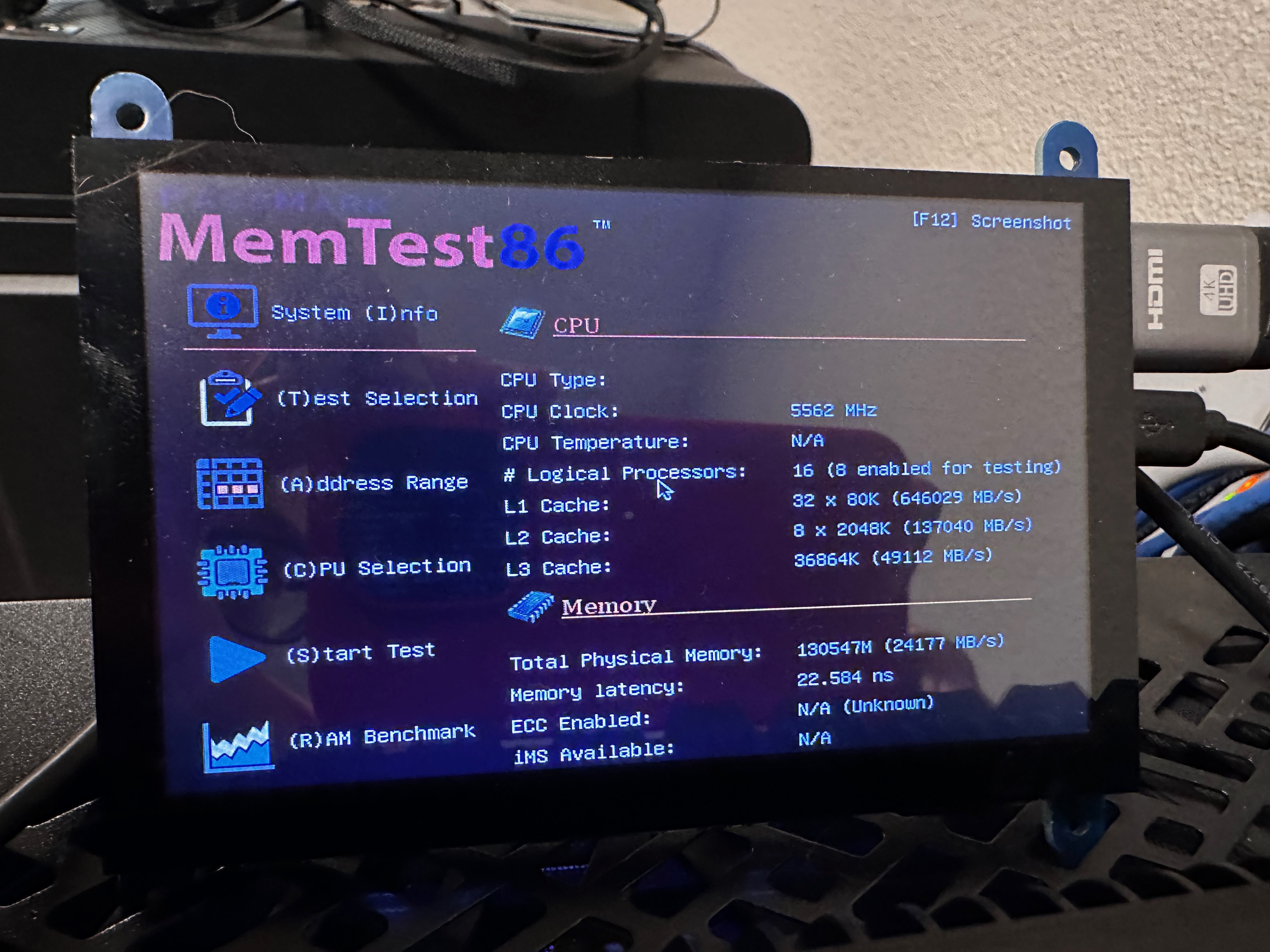

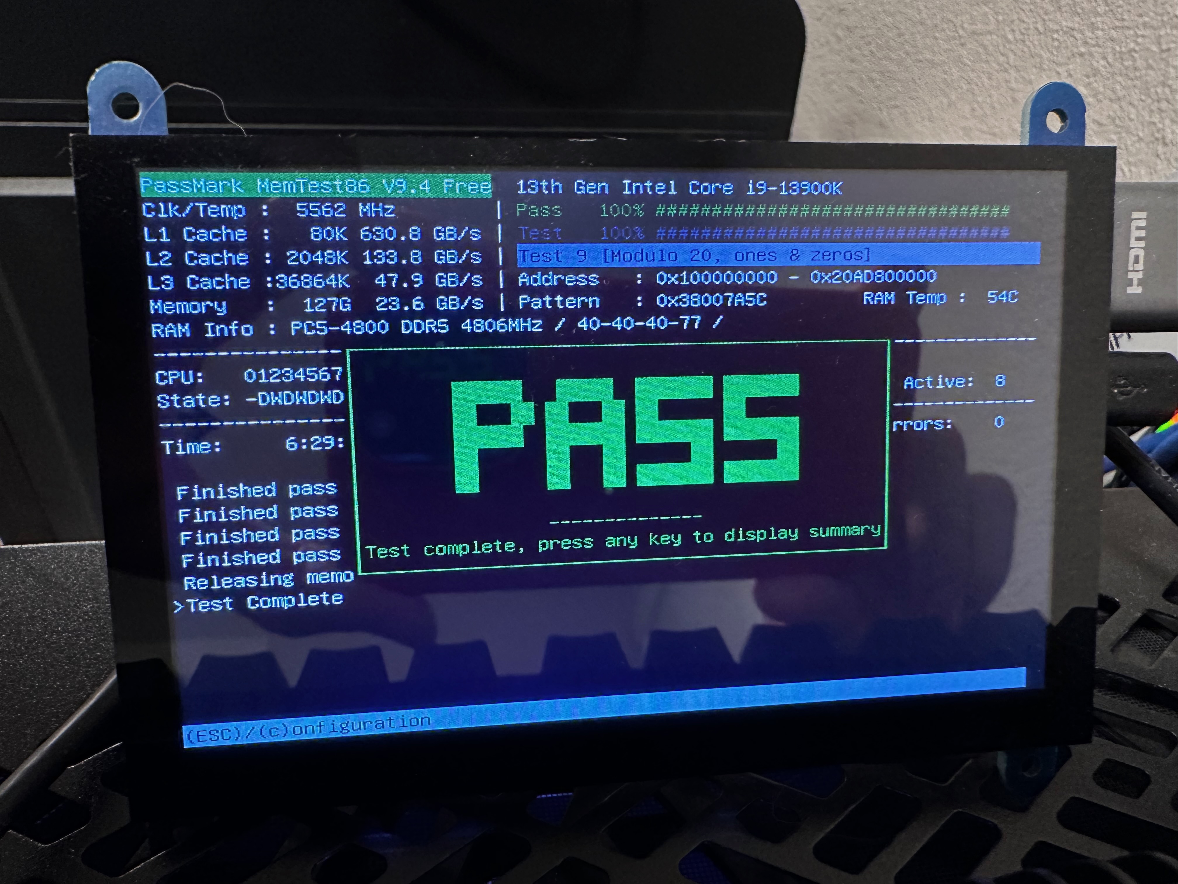

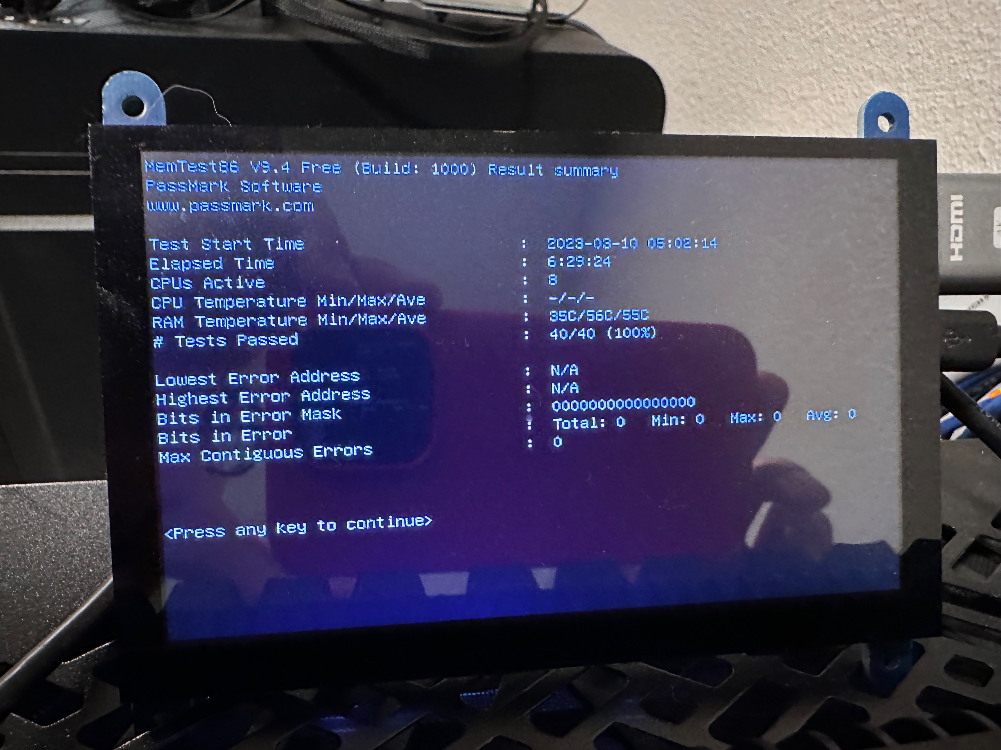

One of the diags is showing various apps segfaulting, run memtest, if no errors are found enable the syslog server and post that after a crash.
Memory test passed fine - see results
