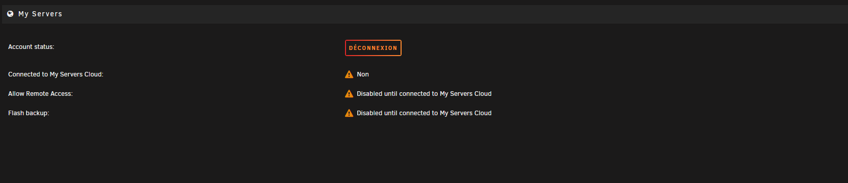

there is a problem since this morning on my side API error Unraid

hi thank you for your answer, I have made several disconnections connection via "my server" and always the same error, I have also restarted my unraid several times but nada

I changed dns, disconnection and reconnection of the "my server" and even a reinstallation of the plugins but nothing helps
Edit ; i'm resolve my problème with ' unraid-api restart '
