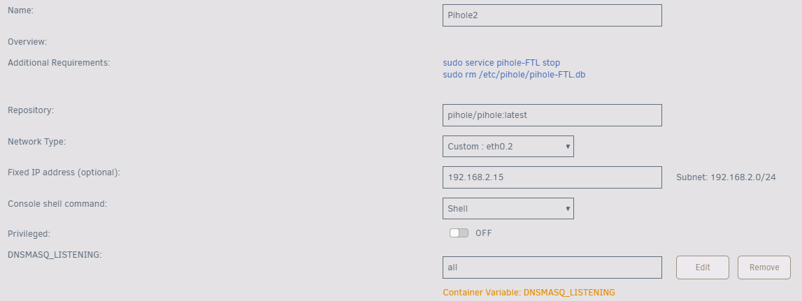

I'm trying to get a second pihole setup to have a failover incase the first one on my Synology NAS goes out.

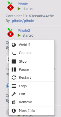

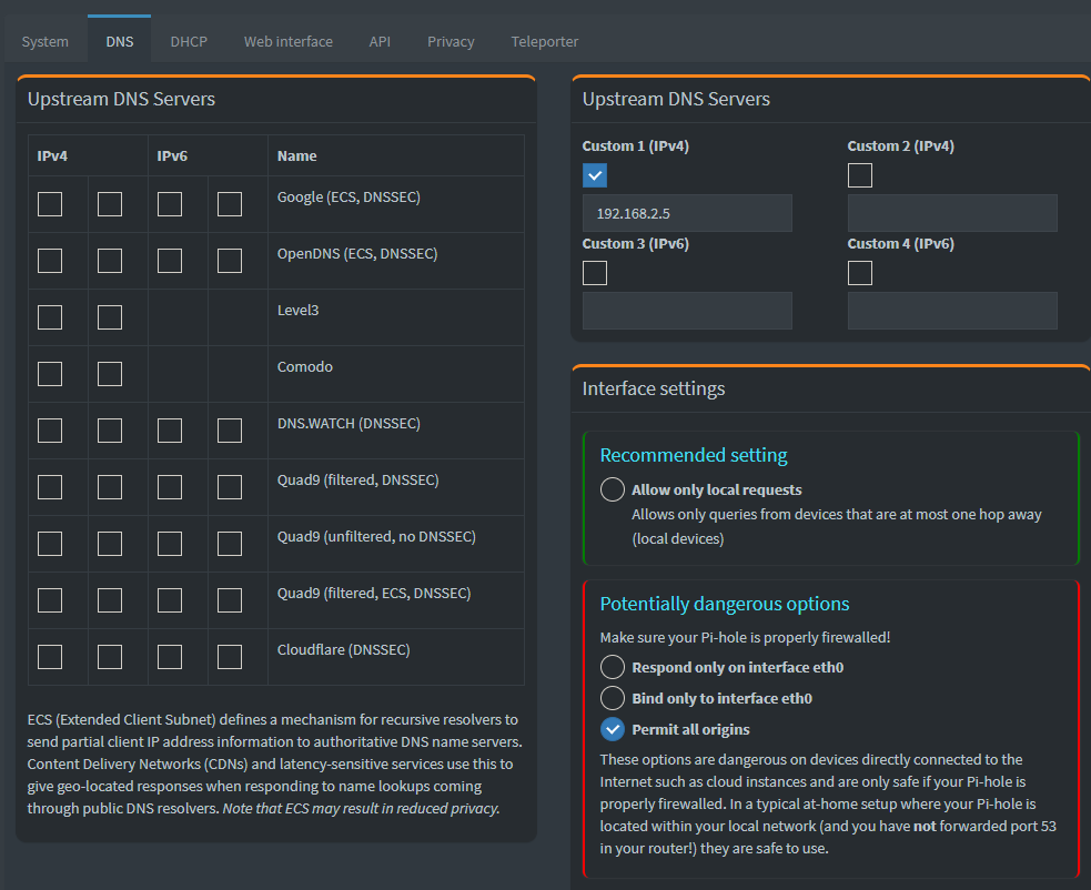

But when I try and setup using custom network, I cannot access the pihole with the 192.16899.203 IP. If I set it up under bridge it then works but only as the same IP as my Unraid server, it will not come up under the specified IP address I gave it (192.16899.203). I did point the IP address on the second image to the first pihole IP address.
The last image shows to use Bridge mode instaead of br0 and that worked but its using the Unraid Ip address instead of the IP address I specified.

With these settings, it states the 2nd pihole is unreachable.
I must be doing something wrong?
Is it because of port 80? Do I need to change it to port 8080?

No, both were different IP.
You should check the logs and confirm 2nd Pihole have start and you must use separate path mapping for 2nd Pihole.
I simple try as below and config 2nd Pihole use custom DNS ( 1st Pihole IP and not set any path mapping because just for testing ), that's all.

The pihole DNS on the second one is pointing to the first Pihole.
