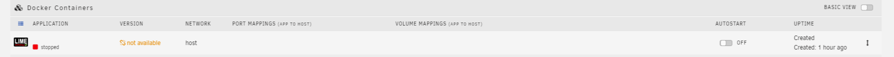

There was an update to the docker recently which I tried to apply. Since applying, it has failed and no longer responds or works.
I am wondering what could be the cause of this failure? The update failed basically.
image.thumb.png.2e9c6aff00f4afa4e47d80a23ba3e598.pngThis is what it looks like now. Does not start and does not allow anything.
What is the best course of action here?

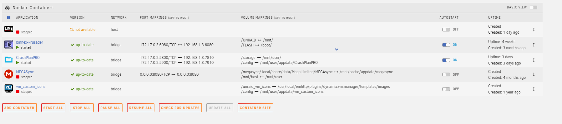

Yes I have a few dockers running. I must also mention that opening up the dockers page now takes 2 mins on average to load up along with the plugins page and also the apps page. Everything has slowed to a crawl.

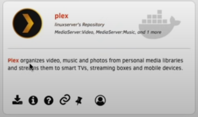

No, it is not that, I just added it 2 years ago
This is the one that was added by following all instructions on this video
Here is the support thread for that container.
If you can't get an answer there, lsio supports their containers via their discord channel linked in that post.
