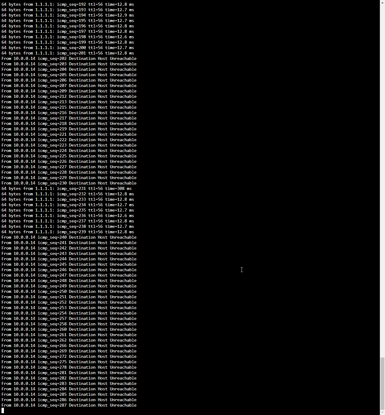

Attempted to just blast wg0 tunnels and start from scratch, I have just a wg0 with a fresh config loaded, and it _looks_ like it's active. The Problem is as soon as I enable docker, network problems start to occur. a basic ping to 1.1.1.1 stops working as soon as docker is enabled (screenshot showing as soon as I activated Docker, and remained unreachable until I disabled Docker), and that's without any containers that use the wg0 Tunnel running.
Where should I look to figure out why Unraid networking suddenly went sideways after just switching WAN ips? (everything else on my network works)
