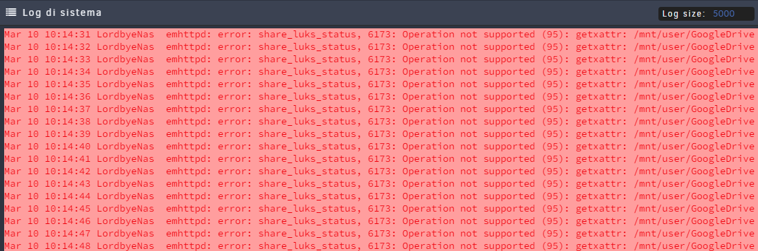

i have my system log flood (every second) by an error:
emhttpd: error: share_luks_status, 6173: Operation not supported (95): getxattr: /mnt/user/GoogleDrive
How can avoid it?
thanks
Don't mount anything under /mnt/user, that should be used by Unraid only, user for example the new UD protected mount, /mnt/addons

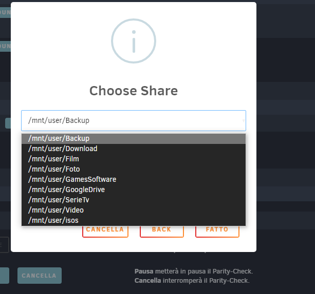

ps: i tried to create a new mount point with unassigned device but i can't use "disk" insted user (see screenshot)
if i try to set it manually i have this error
Mar 27 16:25:10 Nas unassigned.devices: Mount NFS command: /sbin/mount -t 'nfs' -o rw,noacl 'NAS:/mnt/disk1/GoogleDrive' '/mnt/remotes/ENAS_GoogleDrive'
Mar 27 16:25:10 NAS  rpc.mountd[9651]: refused mount request from 127.0.0.1 for /mnt/disk1/GoogleDrive (/): not exported
Mar 27 16:25:10 NAS  unassigned.devices: NFS mount failed: 'mount.nfs: access denied by server while mounting LORDBYENAS:/mnt/disk1/GoogleDrive '.
