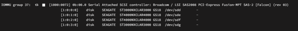

I have 2x 148GB SAS and x2 1.8TB SAS drives in my HP DL380 Gen9 server.  In the backup storage I have 4x4TB SAS drives and soon a 1TB SSD cache drive connected to the server via a PERC H200e HBA (flashed to IT mode).  The card is enabled in the BIOS, the card is seen in UNRAID "System Information" and so are the 4x4TB drives.

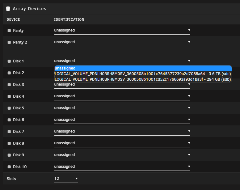

Problem I have is I don't have the option to mount any of these drives into my array.  All I see in the dropdown is the 4 SAS drives I have installed in the server itself.

see this thread, you may need to set something in BIOS. Your drives are showing masked in syslog
Also, seems your drives attached to server which are visible are in RAID mode, which is not recommended
Logical block size:   520 bytes
This is not supported, you'll need to re-format them with 512B sector size.
