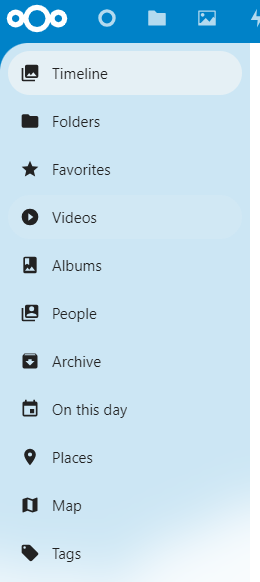

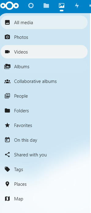

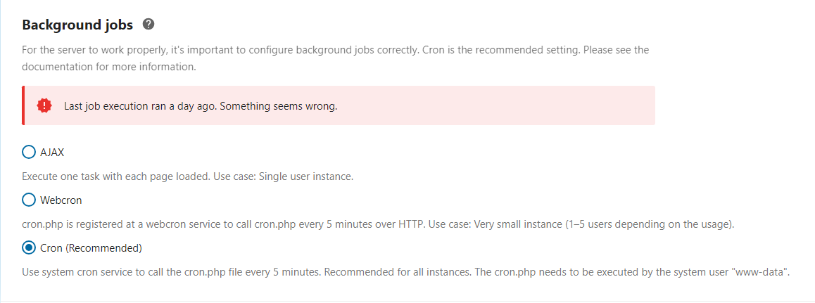

Hi,I have transfered my Nextcloud to your docker image, but I got two issues.
1.after imstall memories and face Recognition, I see people tab in both Photos and Memories' sidebar, but I didn't see Persons tab.Why? how to solve?
2.System Cron job doesn't work. I tried crontab command, it shows command not found. Do we have to install cronjob manually? How?
Thanks
