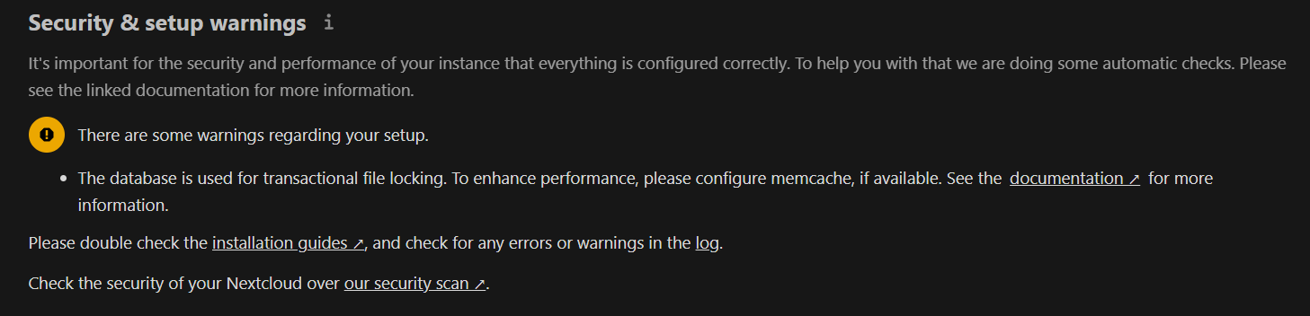

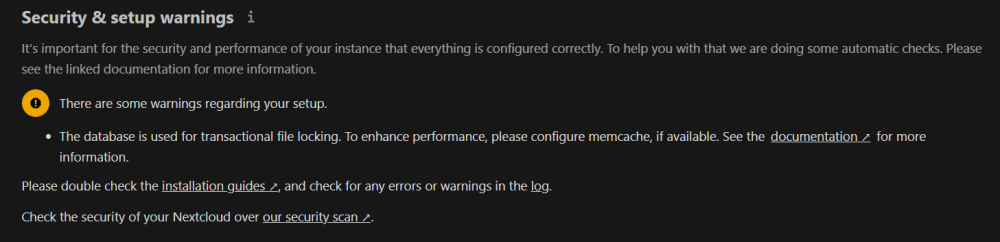

Appreciate you for this work. I am trying to this docker now. As I have been trying to confiugre the docker, I have been going through the security & setup warnings. I am stuck with the following and I am not sure how I can clear this warning. Can you please let me knw what I should be doing here? Thanks in advance.redis.thumb.png.8ba0c23979fd5b4f664ffba36b637c48.png
@Shawn Young
Hey, I had the same problem with cron, but solved it like most people who also use the normal official nextcloud docker.
I installed the plugin "User Scripts" on my Unraid and there a script which calls the cron.php. I'm not sure yet if this is 100% correct, but at least it works and doesn't give any errors.
Skript:
#!/bin/bash
docker exec -u 99:100 Nextcloud-multimedia php -f /var/www/html/cron.php
exit 0
I set the schedule to custom with executing it every 10 minutes "*/10 * * * *" .
When everything works fine it should look something like this. When you got the wrong user or something like that it will show you the error statements. But with no errors it should look like my screenshot.
Also the first few executions were taking pretty long but after that it got faster.
