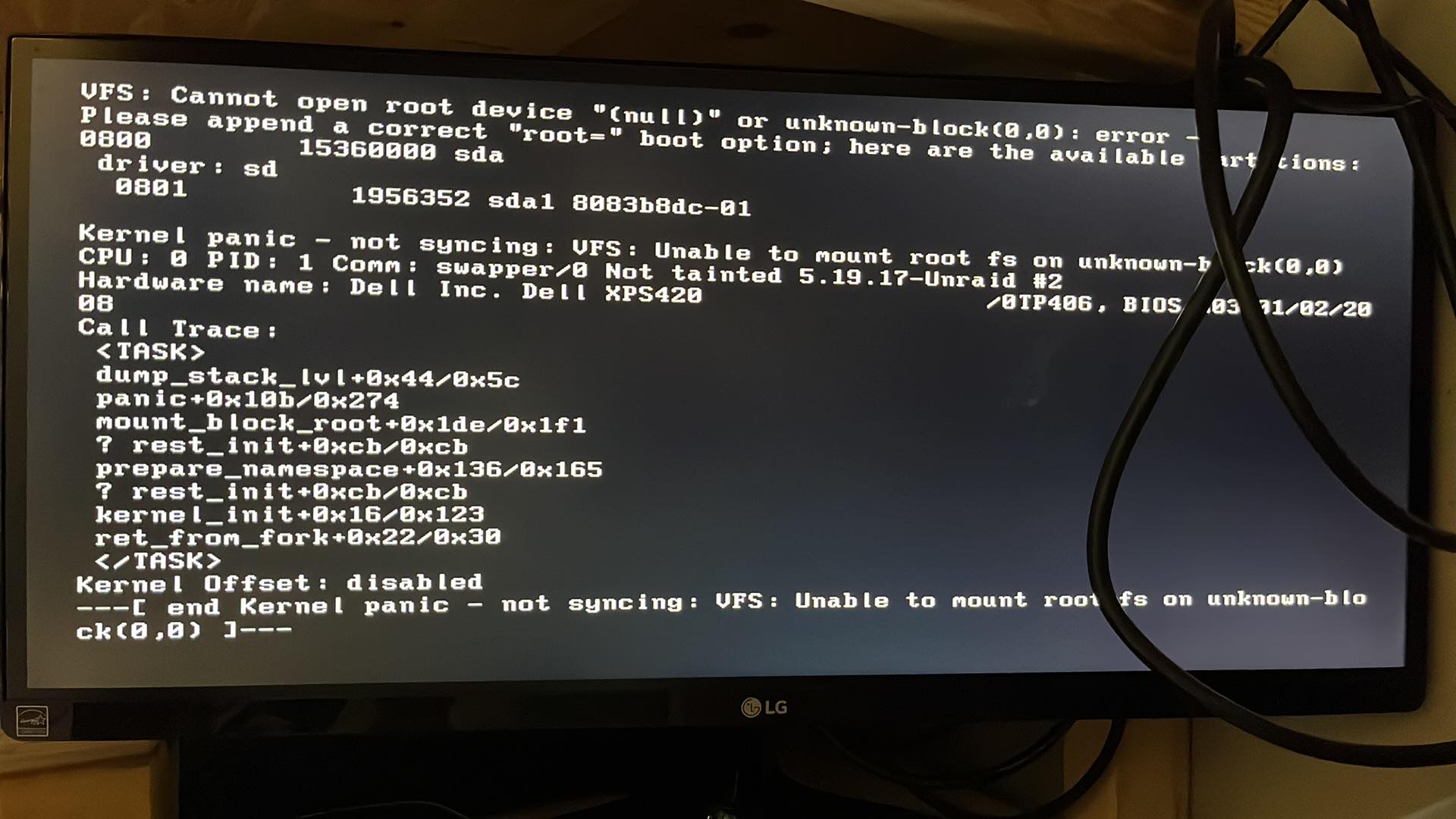

I ejected the USB and went back to my server, inserted it into a different USB port and turned the machine back on. Mind you, Unraid seemed to be running fine before this, besides the update error and Plex install error I noticed. Everything seems to boot up, and then it goes into a kernel panic.
333013930_1269716063953389_8402188927437833565_n.thumb.jpg.15271466a22f9c709ac44fcbbd36c196.jpg
So I moved the USB stick to the slot it was originally in. Booted up, same kernel panic.
So I moved it to a front USB port - same panic.
I went back upstairs, and got a fresh, new USB stick (16GB, new in box), put it in my PC and using ImageUSB, mounted and installed the Unraid boot disk image on the new USB stick.
I then inserted it in various USB ports on the Unraid machine, rebooting, and getting the same kernel panic error. I reinserted the original USB stick and ran Memtest. I left it running overnight and when I got home from work, it was on pass #9, with 0 errors.

Do you have a current backup of the config folder from your flash drive? The config folder is all you need to get going again with your configuration on a new install.
Prepare a new install of whatever version on a good flash drive and see if that will boot.
Thank you for the suggestion! I do. I did not have any issues making an image of the original USB drive, so I appear to have all of those files intact. I've made a new install of Unraid on a brand new thumb drive (16GB) and will attempt the new install tomorrow. (it's late here)

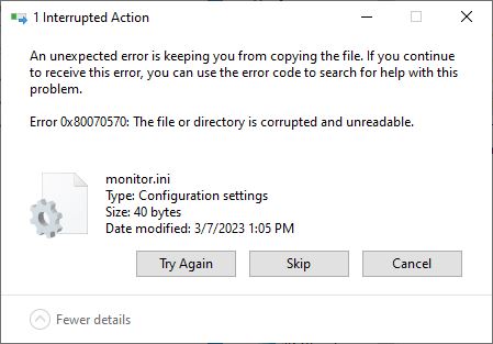

As I was copying the Config folder from the old to the new USB drive, I got the following error:
Perhaps a clue. This file is located in config\plugins\dynamix
Could this impede the graceful booting?

Did you try to boot the new install before attempting to restore your config?
OK - circling back - THIS WORKED. First, thank you. 😁
I had to jump through a few hoops and I'm still ironing out some of the issues/details. I did what you suggested. Created a new Unraid install on a thumb drive. Copied the Config folder. (I realized that the error above was an anomaly. That file wasn't on the original old USB drive, just an imaged version I was using.)  I plugged it into the PC and it booted right up. I was able to access the server normally, and no errors shown. I think the USB was the culprit.
Looking back, I should have known better. When I was FIRST setting up the USB drive, I tried using the Unraid USB installer exe tool. It failed every time. I eventually had to do a manual install. It was wonky the whole time. I should have thrown that USB in the trash; I just figured it had to do with my old hardware, not that it had an error/issue.
Not on purpose. :P After I created the new USB drive, I restarted the PC (for another reason) and it booted to the USB (of course; imagine my surprise). But I did then copy the Config folder from the old USB to the new USB and plugged it into the Dell XPS420 Unraid machine. This worked, as I posted above.
