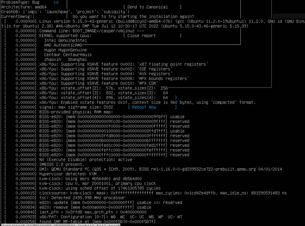

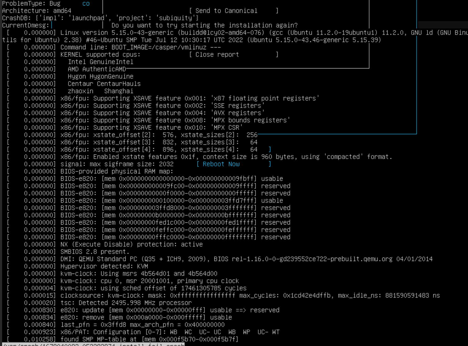

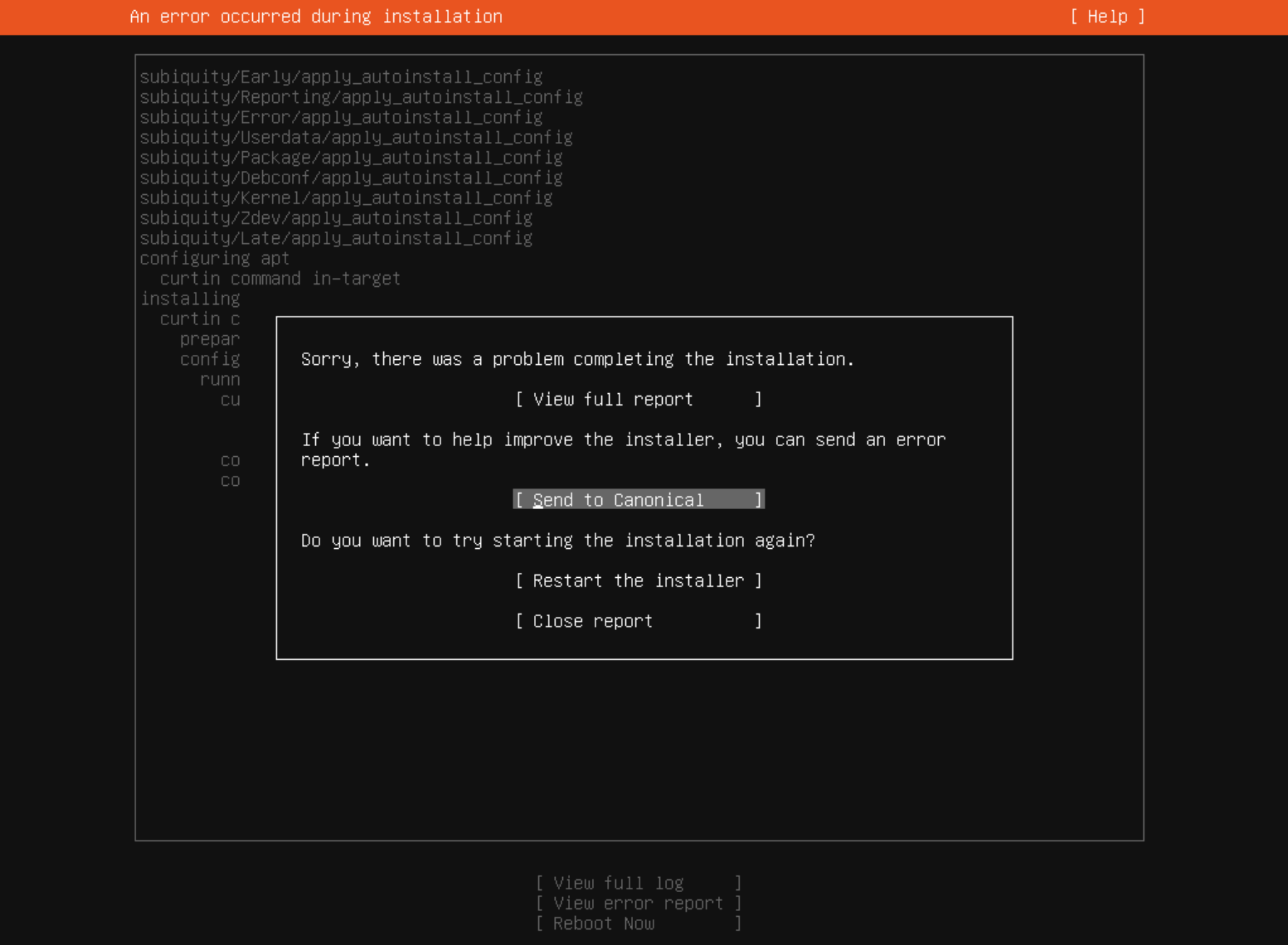

When I try to install ubuntu server 20.04 lts or 22.04 lts the installer continuously fails, it works fine on my physical machines installing without problem. The installer usually fails when I am entering my info. The reason that i believe it is unraid is because it installs on everything but unraid which fails every time. From my more limited testing it also fails on other distributions of linux. Any help is greatly apprechiated.

Try to increase the ram in the vm.
Try with 2 gb, then if it doesn't work and you can, to 4 gb.
I think 2 gb should not fail.
