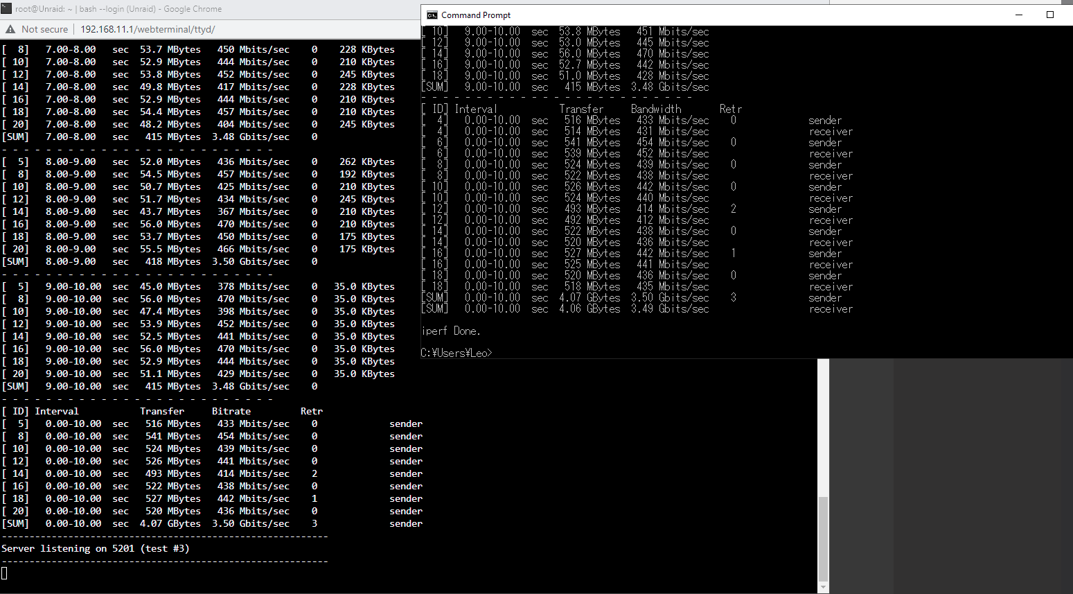

I'm having slower than expected speeds between my Windows 10 and UNRAID NAS which both have a Intel x520-DA1 NIC in them connected directly over a 3m 10Gb/s SPF+ DAC Twinax Cable.
I used "iperf3 NASip -P 8" and "iperf3 Windowsip -P 8" on both W10 and the NAS to see if there any difference but they both reach only 3.50Gb/s speeds which is far from the expected 10Gb/s speed I should be getting.
I've already enabled jumbo frames to 9014 bytes already on UNRAID and W10 PC which helped speeds get to 3.50Gb/s. Also disabled offloading, enabling full-duplex and increased buffers within Windows 10 but there isn't any change in speeds. The latest drivers (version 4.1.249.0) has been installed on the Windows 10 x520 NIC already and CPU usage is below 10% so there isn't a bottleneck there either.
I've tested over SMB file transfers and it indeed caps out at around 450MB/s.

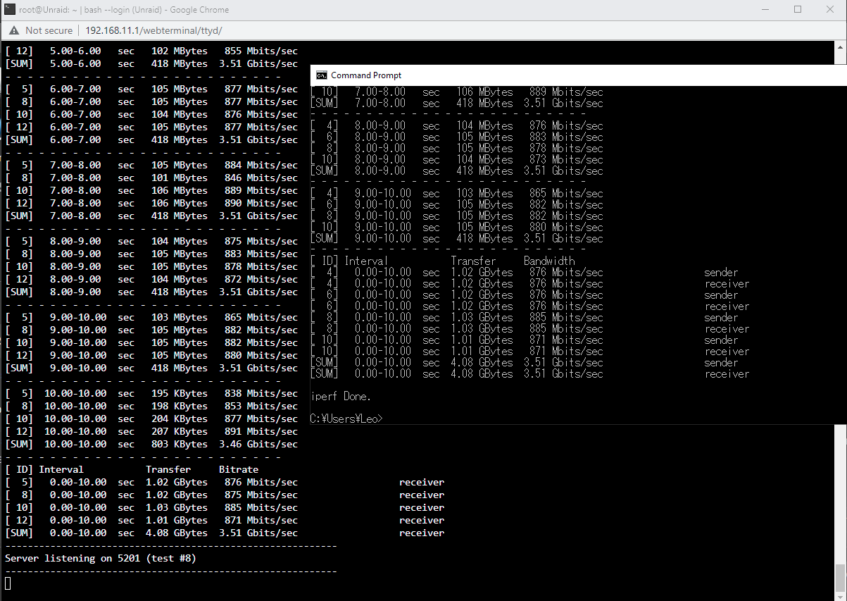

Pls also note, screen capture indicate have retry error too. "Retr column"

not sure why the DAC would cause it because I've seen a lot of people recommend and use a DAC as its much less costly. I can try buy another DAC and see if it makes a difference.
The rety is because I've sent too many request at once, doesn't show up if I do 4 parallel.

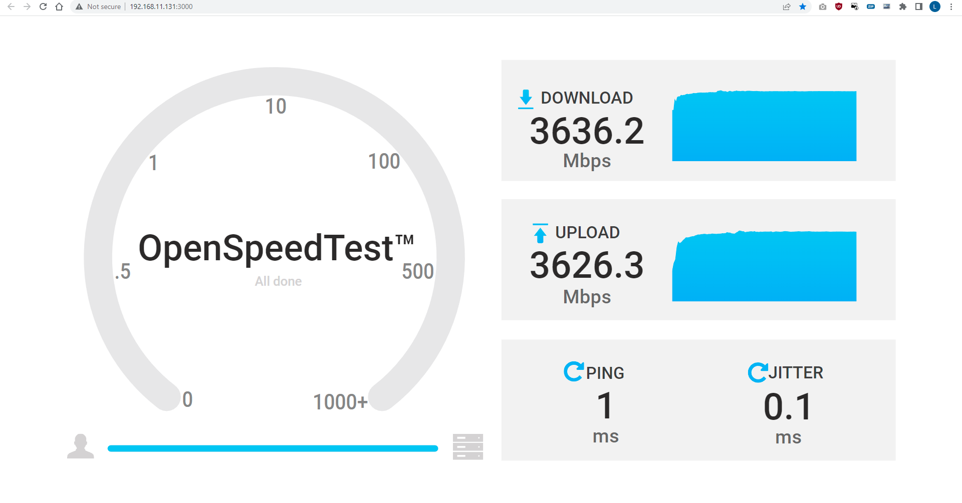

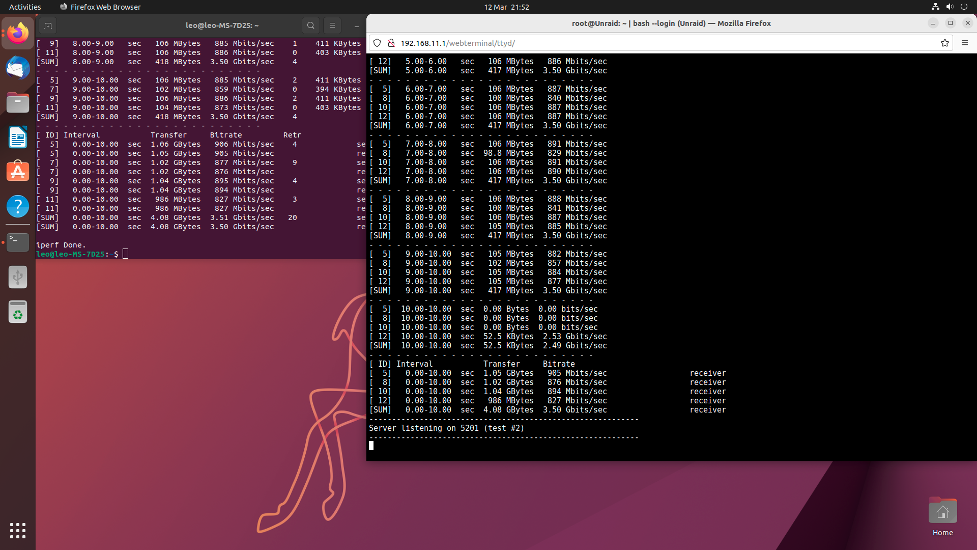

I've tried it in ubuntu fresh install to unraid and it still stuck at 3.5Gb/s. I've also installed the docker openspeedtest to my 10Gb NIC and it still shows the usual slow speed. Any ideas what is going wrong? I didn't expect it to be this hard to set the 10Gb NIC connection up

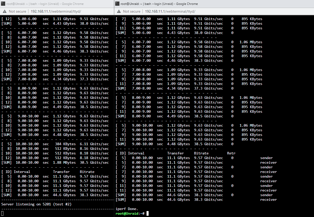

I managed to fix it finally. It was my Windows 10 PC I put the NIC 10Gb on a electrical x1 gen 3.0 slot which was limiting the throughput. I've switched it to a electrical x16 slotinstead.
