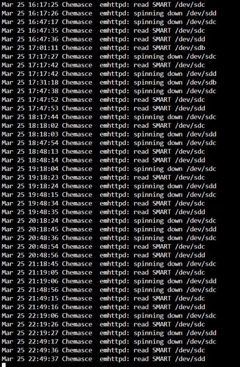

Do you see the "spinning down /dev/sdx" entry in the log?
This happens on the disks in the array: (image)
But when I press green ball in the pools, nothing happens in the log.

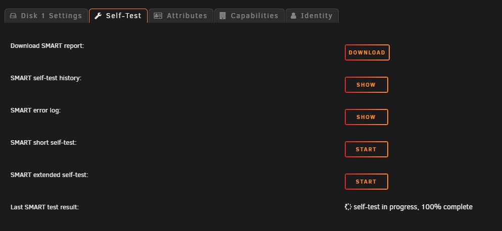

I Have observed that on the disks where I have problems, the smart test never ends
That looks like a controller issue.

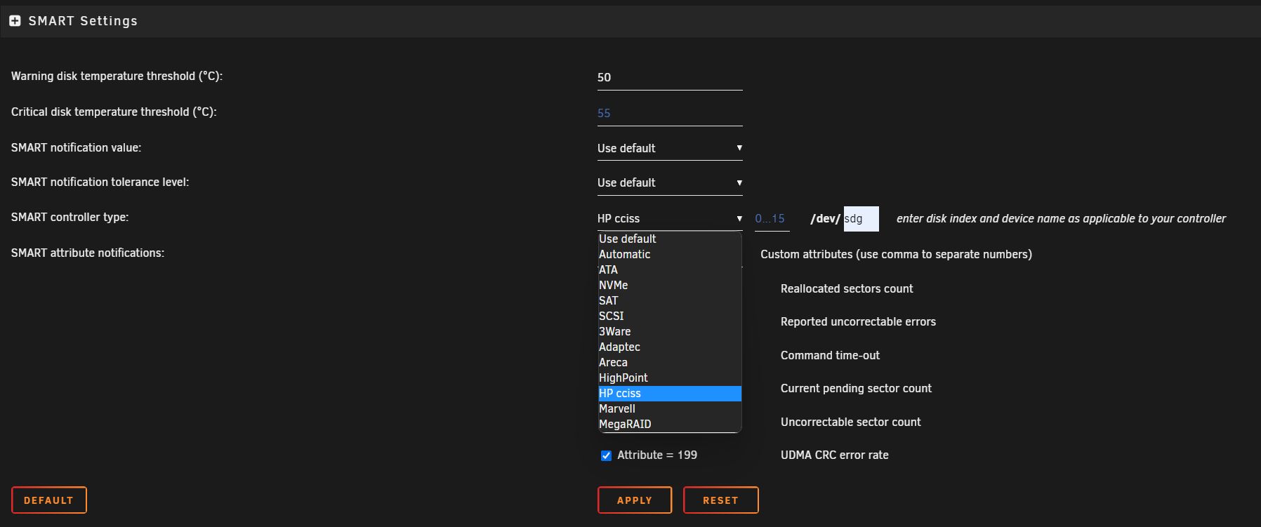

I Have Smart Array HP P822 in HBA mode.
I have to select this?
In that case, how can I know the index?
