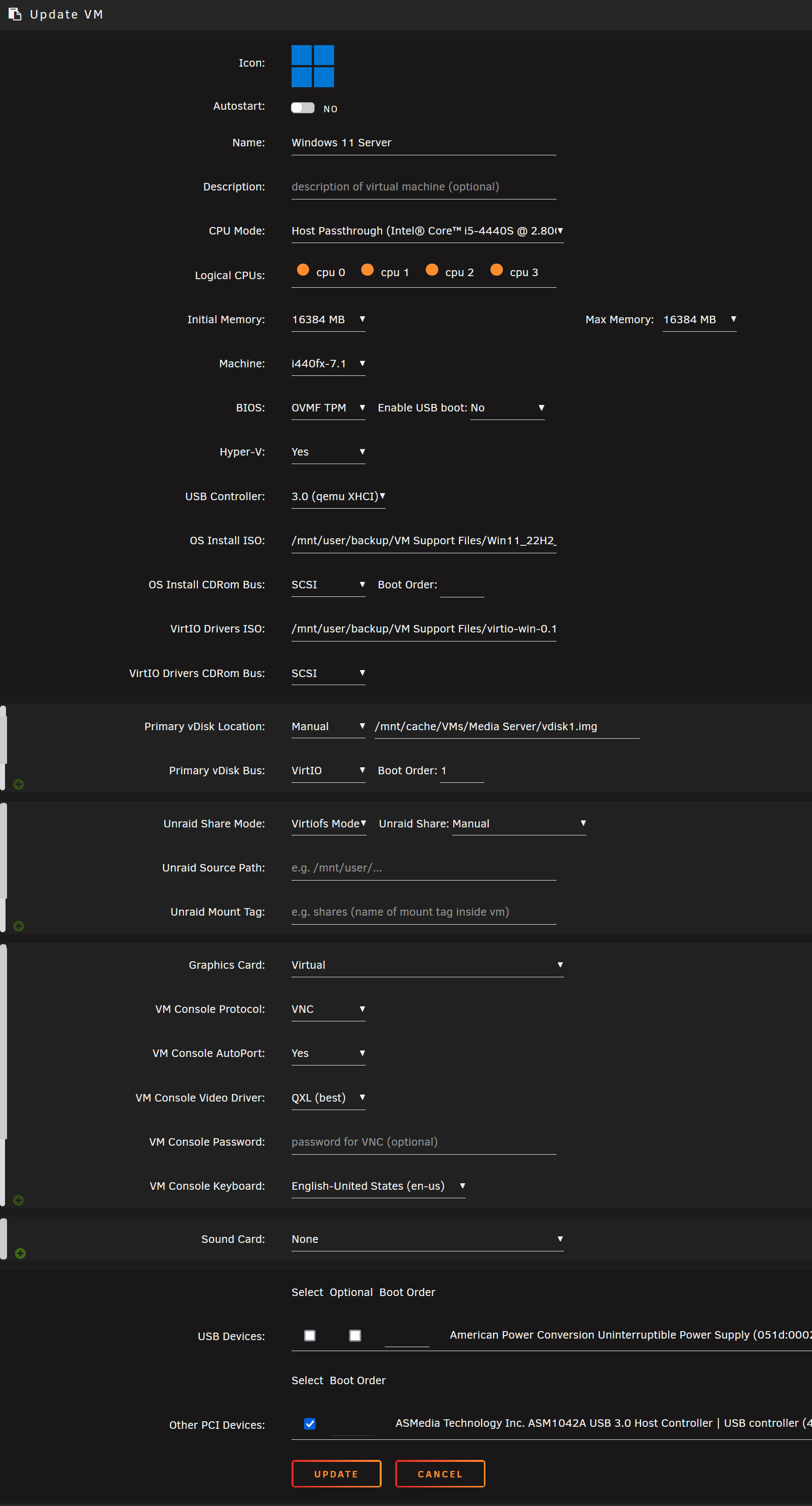

But, I do not have a network adapter in windows now.  The troubleshooter doesn't even find an adapter, so I figured I'd have to change it in the VM setup, but network is not even shown in the VM setting page now, so I can't even try changing the adapter to see if I can get that to force an adapter into this windows install.

The real issue is that the VM setup has just simply removed the network setting part.  There is literally no network setting provided to change.  I could probably figure out how to add them with the XML, but i really don't want to have to dive that deep to fix what i think is just a bug in unraid.
I read about this a couple of times in the forum, and indeed it seems a bug in unraid.
The users solved the issue by deleting the network config in unraid, and creating a new one from scratch. Then magically it seemed the network options were again available in the vm settings.

That's why I said to delete it and recreate with the same settings, it'll have the default network card again and takes 2 minutes.
Sure it shouldn't break when changing options, but the workaround is quick.
Fixed in 6.12 will show without MAC or you can just add back in XML
