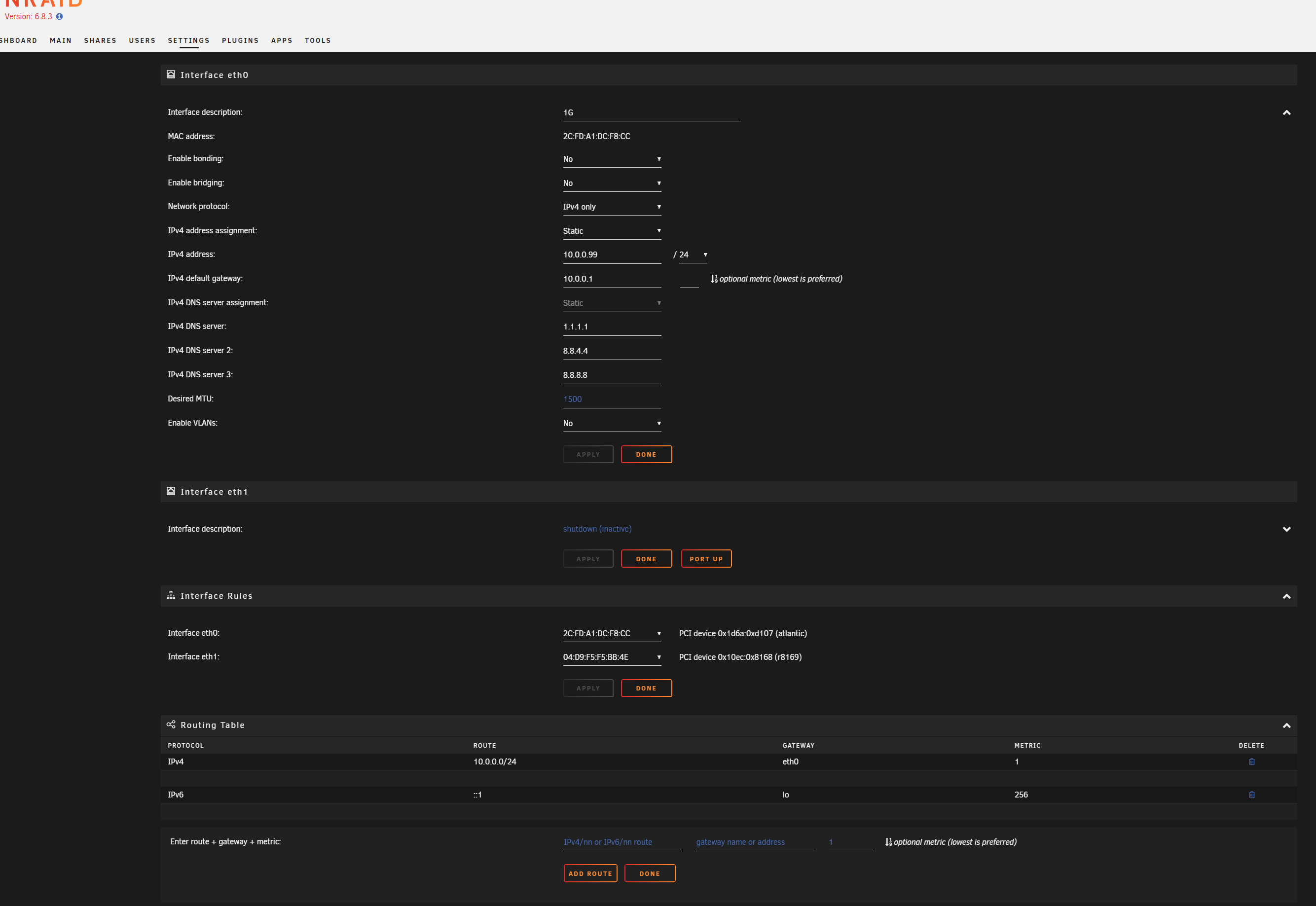

I have finally copied off all the data I care about and am trying to upgrade to 6.11.5.  However, I now have a network issue.  When I launch a ping from the command line (via the web interface) it says network unreachable.  Yet, I can reach that device via the network.  Very odd.  I have attached a screenshot of the network config screen.  When I attempt to use the plugin download optoin to download the latest uraid it says that it fails due to a network failure.  The same with the plugin feed download.
What is odd is that the only method I have to access this machine is on the network.  It responds with the webui on 10.0.0.99.  My primary network is 10.0.0.1 (gateway my windows pc uses) so I am lost as to why unraid doesn't use the network for one half but is able to serve on the network just fine for the webui.  I don't (as yet) have a keyboard and mouse on this machine as it was not needed so I removed them.
My current plan is to recover my license for easeus data recovery and recover the btrfs data from my windows box as there is only one primary drive that is not working.  If someone here can give me a couple of steps to get the network operational, I will attempt them.  At the end of this, I will have a license for unraid that I am not using.  If the EULA says I can sell it, it is for sale, otherwise I will archive it for potential future use.
Try deleting/renaming /boot/config/network.cfg and reboot, it will go to default dhcp settings.
