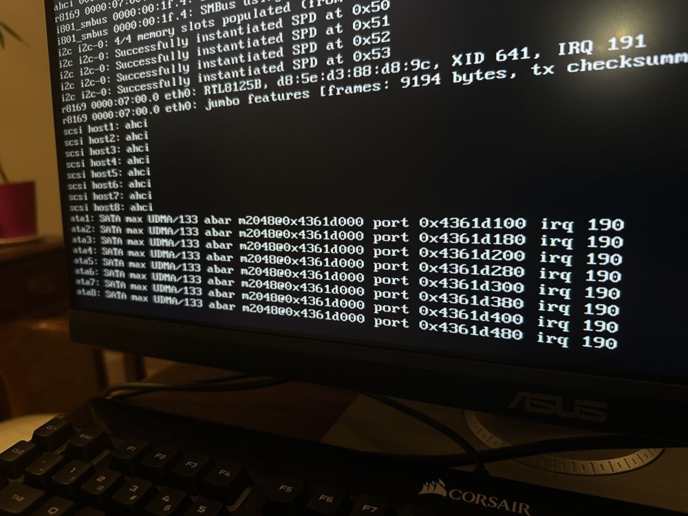

6.10.5, can’t install. stuck on sata initialization.
Hello,
setting up my first Unraid server. 6 hard drives, two (18tb) wanting to be used as the new pool and the others just to transfer data over. There are 3 nvme drives connected, one having Ubuntu installed. I do not want to format that drive cause some files are on there. Nvidia drivers corrupted my install and I decided to just to Unraid. Ram was working just fine. Gpu installed. Keeps hanging on “
ata8: Sata max UDMA/133 abar m204800x4361d000 port 0x4361d480 irq190”
Does this after going ata 1-7. I unplugged sata drives and made a fresh USB on 2.0, still nothing. All the requirements on the install page were followed. Xmp also disabled. Drives work working as well when coming out. All recognized fine in BIOS. Safe mode didn’t work either. No sata controllers, all directly onto the board. Not sure what else to look at. I tried finding a response to this but with not great avail. Thanks.

Yeah, there aren’t any plugins installed. Did boot UEFI, legacy and with & w/o gui mode.
