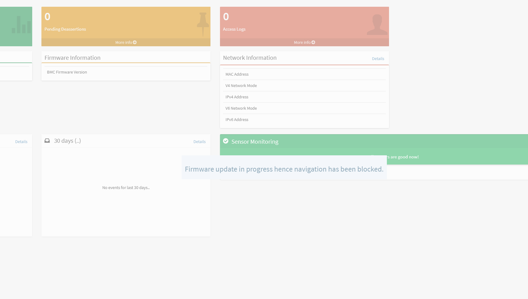

Man, no matter what I do, this motherboard will not boot from an EFI based USB image. Ended up having to clear my CMOS as I fiddled with so many things I eventually couldn't get it to post at all.
I got it to finally boot the Memtest USB drive but somehow in the process I have bricked my IPMI 😄
It's been like this since my last post pretty much
Seriously f**k this motherboard.
So on the one hand, I ran the 4 pass memtest with ECC polling enabled twice and no errors... so dont think it's that.
On the other hand, the ASRock Rack support team supplied me with some SOC flash tools, but they don't recognise the BMC image to fix my IPMI.
I managed to get the board alive again through what seems to be nothing but sheer luck, however I didn't get to the bottom of why there is constant crashes.
