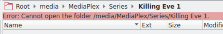

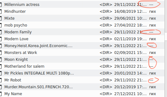

since few weeks, after change hard drive on the pool I lost the access to few random folder.
On Krusader when I m exploring my folder, I have few folder that I can t acces. Those folder are not visible on my PLEX server too.
But When I go the my ''share file'' I can  see and download the files. They are not corrupted.
It s look like permission error, but I can t see where to fix it 😅
Any Idea ??
Drag attached :)
Thanks !!

From what I see, this is the view from the Plex Docker/VM.   I am assuming that it is running Linux based OS.   IF that is so, there should be permissions of owner, group, others as well as the name of the owner and group.

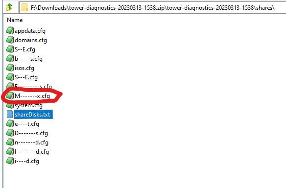

It is necessary to map a location on your Unraid file system onto a mount point on the Docker/VM.  Looking at your diagnostics, I find this:
This looks to be on the path shown in the first screen capture in your post.  Did you map that Unraid share to the /media directory.
But I see nothing in the second screen capture that looks like it a part of that path in the first one-- the 'Killing Eve 1' directory.
On the Krusader Docker for Unraid, if you <right-click> in this section    image.png.eaa2bb30ff2276dcbb7e8677fd074e44.png  of the tool bar, you can turn on the owner, group and full Linux permissions.  If you do this in your Plex app Krusader, that will help in evaluating your problem.
