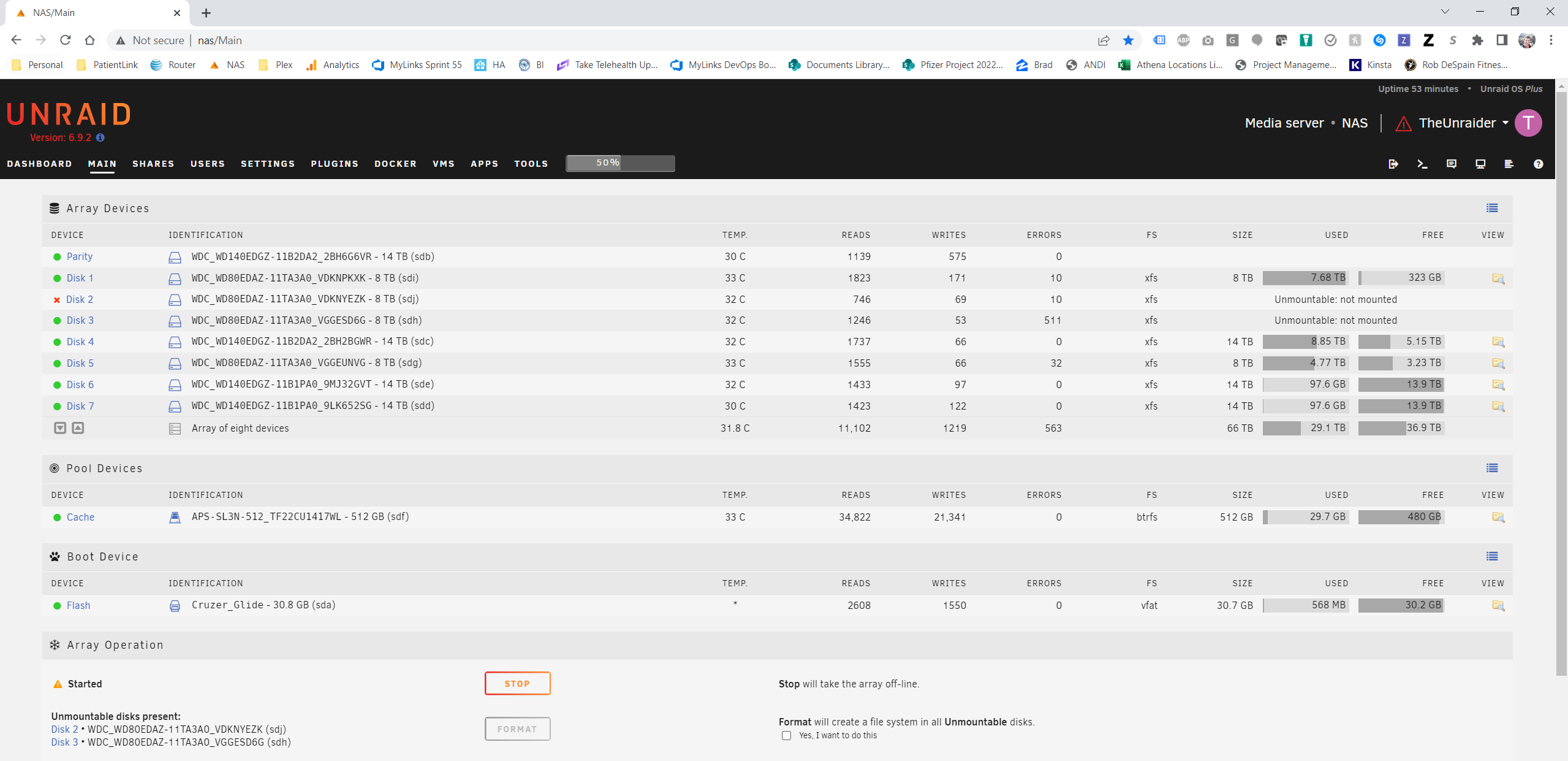

Reading through the forum, it looks like next step is to check Disk 2 using the "Check File System Status".  I stopped the array, put it in maintenance mode and started it again.  I used the GUI and ran a check with option "-n".  It reported back:
Phase 1 - find and verify superblock...
superblock read failed, offset 2199023247360, size 131072, ag 2, rval -1
fatal error -- Input/output error
I was hoping it would give me more info than that.  Don't know what to do from here.
NOTE:  I also noticed disk 3 which wasn't having problems before, is now reporting "unmountable disk".  Only happens randomly as a I start and stop the array.  Sometimes it mounts, sometimes it doesn't.  Odd.
image.thumb.png.c88952b73ff4e58df5797590cb039ed7.pngnas-diagnostics-20230319-1549.zip
There are know read errors from disk3, also look like a power/connection problem, check/replace cables and post new diags after array start.
