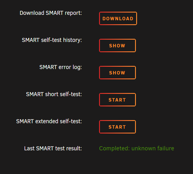

How can you tell if the disk is bad on the SMART Test? I have attached mine to see if anyone know if the disk is bad or it is just something that failed on the backbone of my NAS. All other disk are fine. Any help is greatly appreciated. I don't know how to read hard drives failures.

Run an extended SMART test, but SMART is showing some issues, including a lot of reallocated sctors, disk was also run pretty hot in the past.
Running an extended test. Will post once is done. Thank you @JorgeB
I followed the instructions on the rebuilding a drive onto itself. It will take at least 4 days. Geez luis that is a long time.
Since the SMART test failed, I would recommend replacing the disk.
