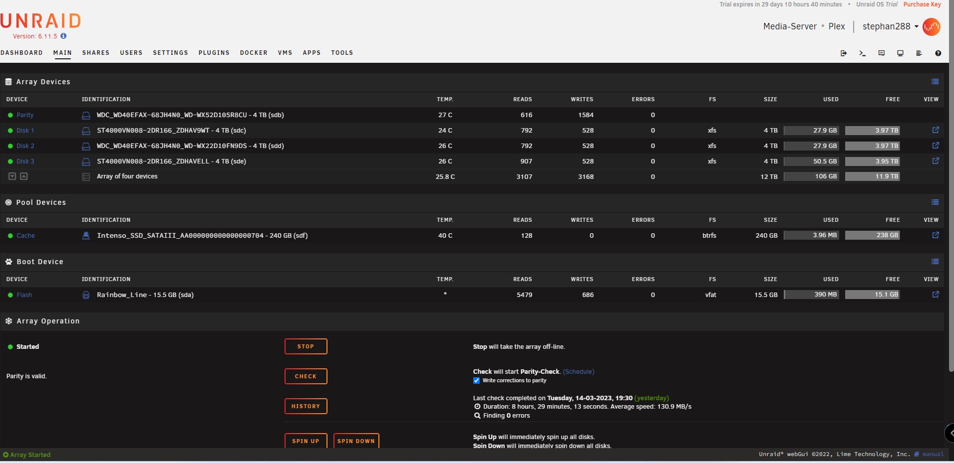

Attach a screenshot of the MAIN page of the GUI, the entire width from the top of the parity drive to the bottom if possible.

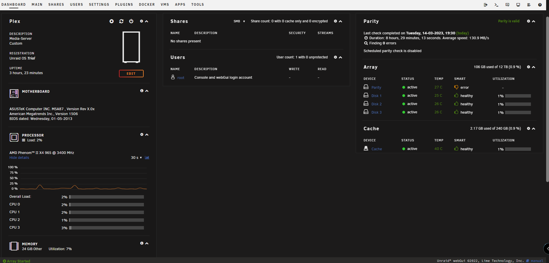

The Error shown on the Parity drive is the result of a single  UDMA_CRC_Error.  This is a non issue.  On the DASHBOARD tab, click on that 'thumbs-down' icon (Can't remember if it is left or right click) and tell it to ignore the error.
The screen capture is of DASHBOARD tab not the requested MAIN tab.

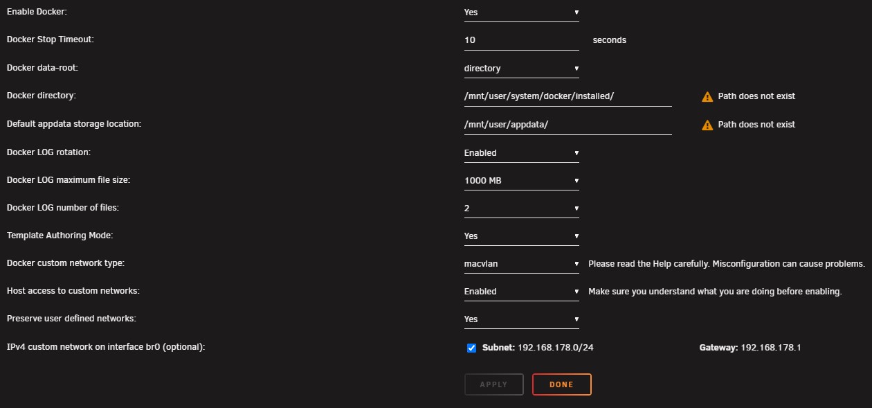

On the SETTINGS   >>>   DOCKER
Change the    "Enable Docker:"     from 'Yes'  to 'NO'  Click on APPLY and then DONE.   You need to do some server setup before you can start install any Docker.  You need to set up Shares.  You need to consider setting up Share users.  You need to do some research as to what directories, files, and (possibly) databases that PLEX will be expecting to find on your Unraid host.  You will have to have the Unraid path information to those resources so you can map/mount those host locations onto the PLEX Docker file system.
