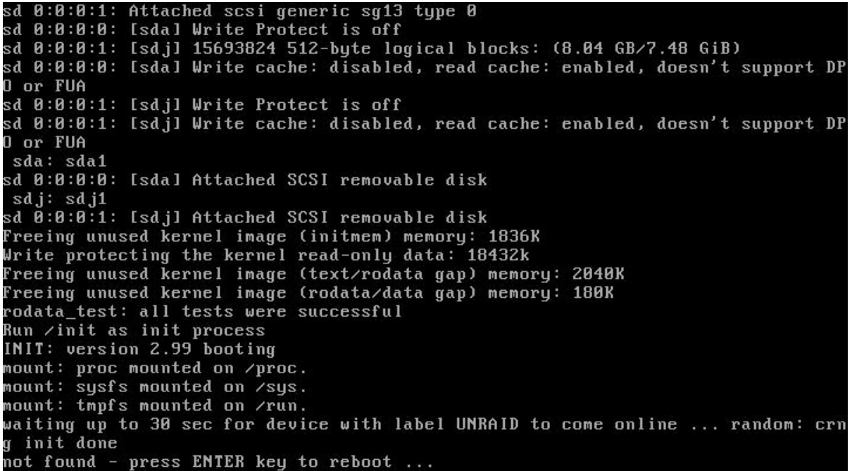

waiting up to 30 seconds for device with label UNRAID to come online...
I know this was reported with past versions of Unraid but I have not seen it be an issue for a while.  A few days ago, I started seeing this message when the server boots: waiting up to 30 seconds for device with label UNRAID to come online...
Pressing the ENTER key to reboot does a reboot and then it comes back to the same message.  Lather, rinse, and repeat.
At first, the message would appear on one boot and then with a reboot, it started fine with no error.  Now it happens on every boot attempt (reboot or cold boot) and I can't get the server to boot.  Fortunately, it is my backup server.  I was a rebooting a lot working through some IPMI issues.
Everything was fine until it wasn't.  The only thing I have done recently that would affect /config is update plugins and docker containers.
I have tried the following:
- reformat USB, download 6.11.5 from Unraid, net, manually install on flash drive, restore /config folder from a backup
- try a completely different flash drive
- run chckdsk in WIndows on the flash drive (no errors found)
- USB Creator does not recognize the flash drives I have tried (admittedly just generic ones to see if I could get something to boot)
Flash drives are USB3 but in a USB2 port in the server.

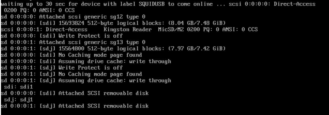

What if you rename the flash drive to something else and then try adding this to the syslinux config append line
unraidlabel=NEWFLASHDRIVENAME
59 minutes ago, Squid said:
Complete shot in the dark.
Well, shots in the dark are all I have left now.
  1.  Reformatted flash USB with the label SQUIDUSB
  2.  Could not make bootable as it was looking for a USB label UNRAID
  3.  Edited make_bootable.bat and set the tag to SQUIDUSB
  4.  Ran make_bootable.bat successfully
  5.  Edited syslinux.cfg append line and added unraidlabel=SQUIDUSB
  6.  Booted up Unraid 6.11.5 from the SQUIDUSB
Result:  Same problem with a different name.

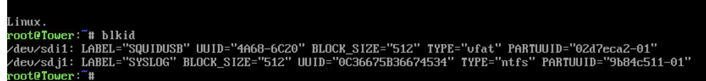

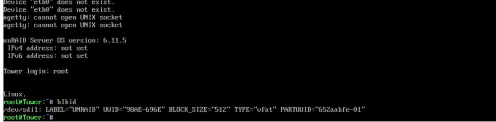

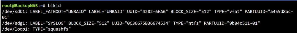

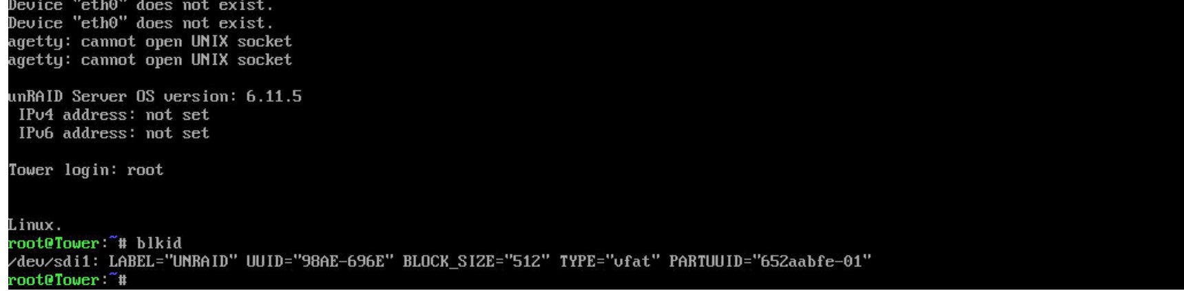

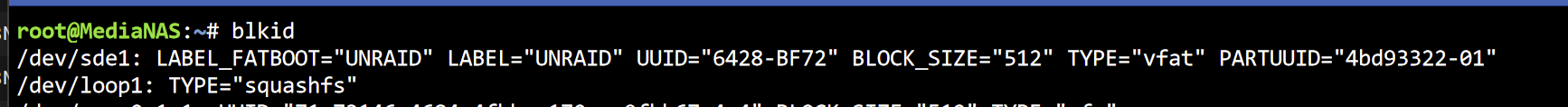

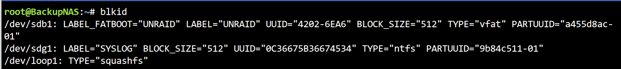

Here is a difference I see in the system that can boot Unraid 6.11.5.
Results of blkid show LABEL_FATBOOT="UNRAID" before LABEL="UNRAID"  I do not see the LABEL_FATBOOT entry for blkid on the system that cannot boot Unraid 6.11.5.  I am not sure what that means.

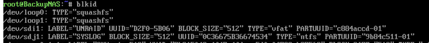

System that cannot boot to Unraid 6.11.5 show this (booted to Unraid 6.9.2):
According to Limetech, 6.9.2 used udev to identify the device labeled UNRAID and 6.11.5 uses blkid.
Edited by Hoopster

And, yes, this one when successfully booted also has the LABEL_FATBOOT="UNRAID" in blkid
