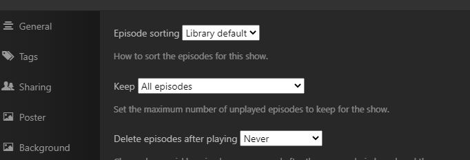

Check your plex library settings to make sure none of them are set to delete after watching.
I see 'Allow media deletion' under the general library settings, but nothing that says delete after watching.
The only place I see that option is on a per show basis for like the 3 shows that happen to remain in my library, but that setting is turned off. Not sure how that would have been enabled for all of my shows overnight.
