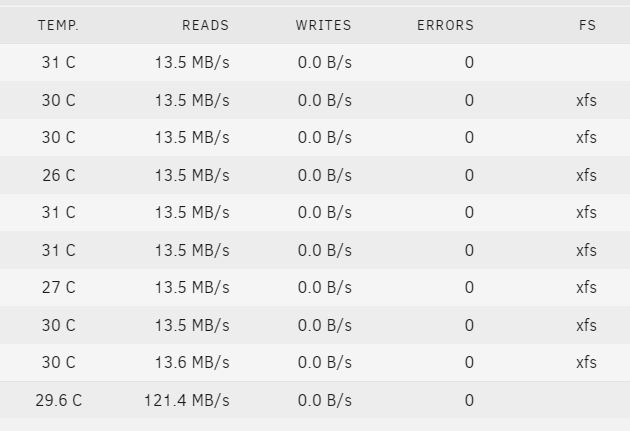

I've carried out the bios check, but for ports 5-6, there was only IDE available, however, for ports 1-4 there were multiple options. So i selected AHCI under 1-4, this automatically switched the ports 5-6 to AHCI aswel.
I've attached a new log, not sure if the check needs to run for longer?, but it looks like its still the same.
server-diagnostics-20230315-1427.zip
Load is quite high, but would have though that CPU would be capable of more, run a test with the diskspeed docker to confirm disks and controller are performing as expected.
