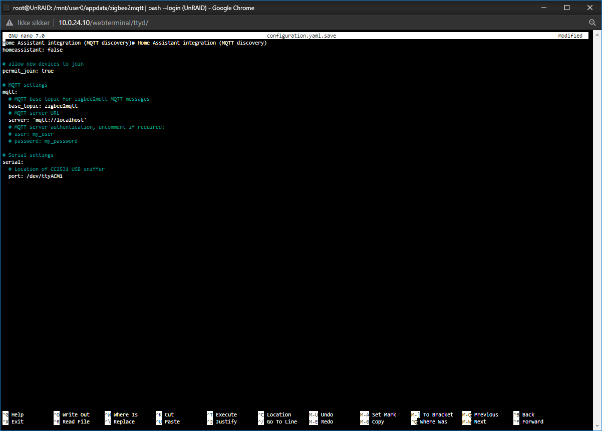

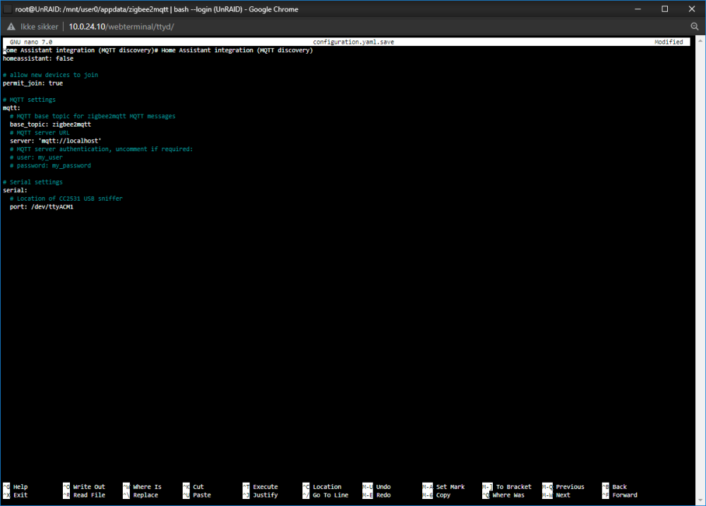

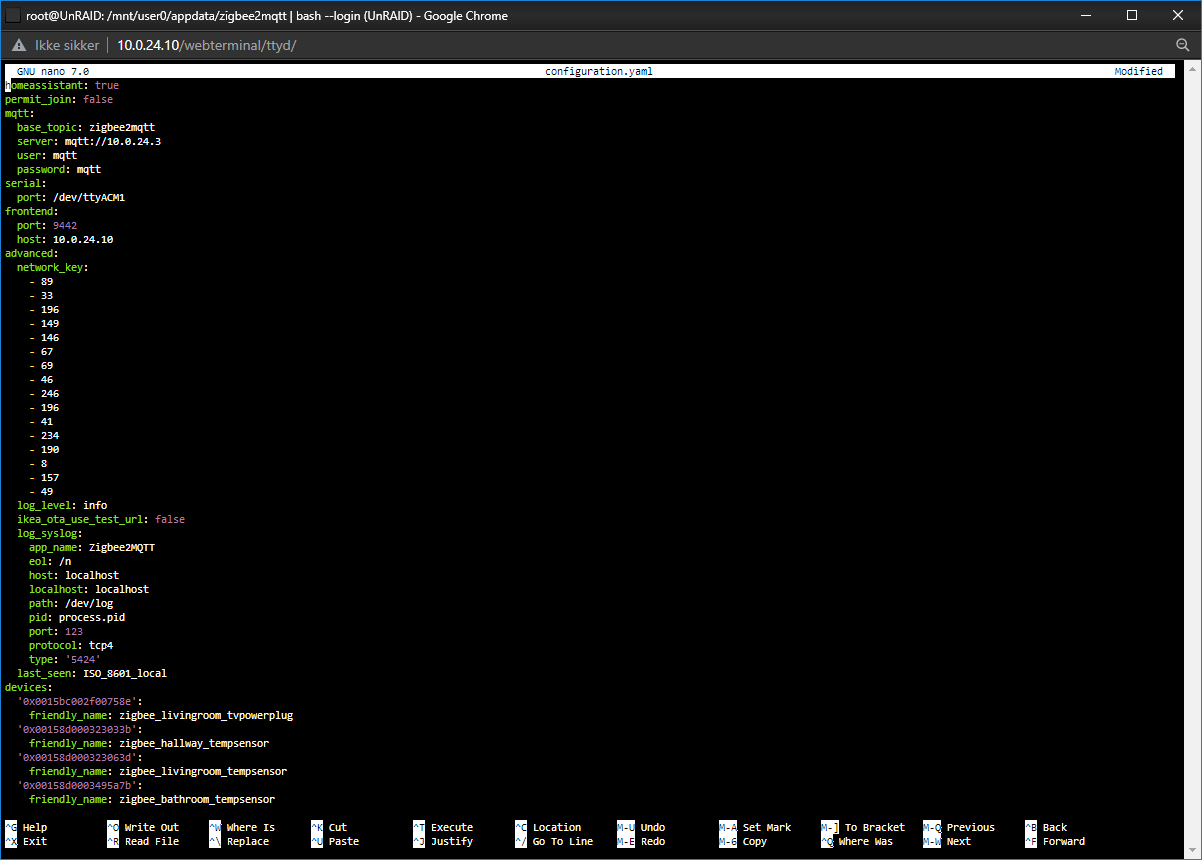

used the cli to change the config of configuration.yaml and configuration.yaml.save using nano
root@UnRAID:/mnt/user0/appdata/zigbee2mqtt# nano configuration.yaml root@UnRAID:/mnt/user0/appdata/zigbee2mqtt# nano configuration.yaml.save

serial:
  port: /dev/ttyACM1
Can anyone explain why this is failing?

I solved this today by adding "adapter: deconz" to the configuration.yaml, this is required for ConBee and ConBee II (and RaspBee and RaspBee II, but they are likely not used in a UnRAID setup)
serial:
  adapter: deconz
  port: /dev/ttyACM1
https://www.zigbee2mqtt.io/guide/adapters/#recommended
