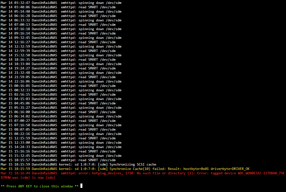

Hey all,
Would someone be able to advise me please.
Is this a sign of a failing disk or some weird SAS controller bug?
I had two drives fail a couple of months ago and now i'm thinking either my SAS controller is the issue or i'm really unlucky 😂
Thank you for any help or suggestions.
dansunraidnas-diagnostics-20230315-1817.zip
2023-03-15 18_23_19-_var_tmp_sdm.run.sh (DansUnRaidNAS) — Mozilla Firefox.png

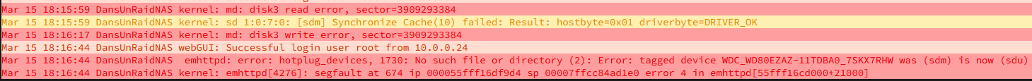

Seems I also cannot get my array to stop.
Looks more like a cable/connection problem, and SMART looks OK.
emhttp segfaulted, so you need to reboot, try typing reboot on the console, if that doesn't work after 5 minutes you will need to force it.
Hey, thanks @JorgeB
I was thinking this but I replaced all the SAS cables with higher quality lock in cables and double checked power connections a couple months ago, uptime is 1 month 15 days without issues.
I'll give it a reboot and see what happens.
