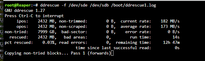

Ok, I did ddresucre, I'm a bit confused because it finished instantly.. Was this drive empty?

ddrescue does a sector by sector copy, does not matter if there's data or not, strange part is the recued amount.. never seen that before.

OK, I think I know what happened, you used an existing log file, ddrescue will resume if you use an existing log file, so if that was from a complete rescue it won't do anything, use a different log file or delete the existing one.
oh snap! I think we are getting somewhere!

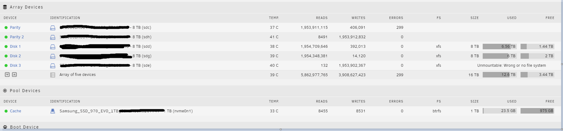

So the server would never rebuild and just say mounting forever. So I was just playing around and put a new disk in the parity2 spot. Once I did this everything started rebuilding. It finished this morning and now my main screen looks like this. Looks like Disk 3 still has some issues, and I think there is something wrong with my main parity disk as it is showing 299 errors and the self test fails to read.
You should not rebuild, you should do a new config (Tools -> New config) with the cloned disk3 installed in place of the old one.
