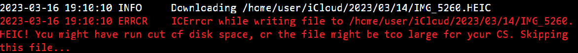

Hi all,
I am trying to make a offline copy of all my iCloud Photos using the following Container: https://hub.docker.com/r/boredazfcuk/icloudpd/
It all works fine until the moment where the container wants to actually download and therefore create files in the folder I mapped it to:
Thaats the mapping:
Can somebody help? I wasn't able to solve the problem on my own using the docs ...

Solved by steff94
Obviously this problem was already discussed without real "solution" ...
When you give an UD to a container you should typically set the mount mode to read/write - slave, see if that helps.
Also make sure permissions on the drive match the container's.
