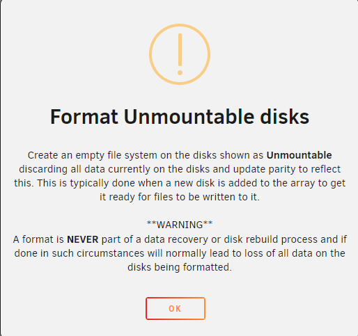

Disk9 was unmountable:
Mar 18 00:54:38 unraid kernel: XFS (dm-8): Unmount and run xfs_repair
But instead of running xfs_repair you've formatted the disk, so any data there is gone, restore from backups if available, if there aren't any only option is to use a file recovery util, like UFS explorer.

Things were likely correctable/recoverable until the format was done, which the Unraid GUI very prominently warns about NOT doing if you have data to recover.
yeah, that's just standard "if you format a disk it will delete all data" - not a very important "hey if this was previously a data disk try a repair first!" at that point.

If a disk fails a write then Unraid does NOT unmount it - instead it disables the physical drive (I.e. stops writing to it because it no longer matches parity) and starts emulating it.   If bad file system data was written the file system is corrupted and you need to run a file system repair (which can be run on the emulated drive).   Parity is not about protecting files - it is about protecting against a disk failure.
The dialog that Unraid pops up when you select format is by no means a standard format warning - it explicitly warns you that running it will prejudice any data recovery and will update parity so that the data is no longer recoverable.
This is a bit more than that, even mentions the parity is updated. It must not have been read.
