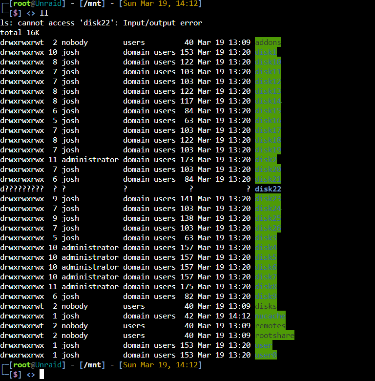

I put the 14 tb drive that I thought was DOA back in, and it seems to be working now, but there's something screwy going on.
The rebuild of disks 10 and 22 is going but very slowly.  The appdata share has disappeared from the shares list, but I can see it in the shell at /mnt/user/appdata.
When I looked in /mnt disk22 is saying I/O error (screenshot)
I've attached a new diag file.

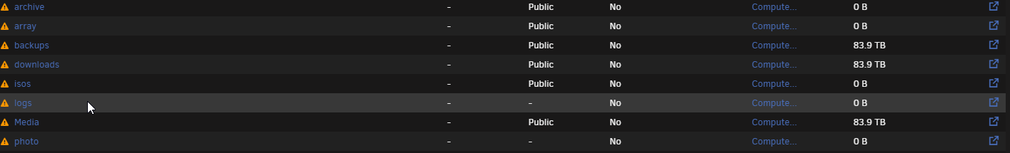

Some shares are reporting 0 free space while others are showing the 84 TB free on the array.  The shares reporting zero are not accessible from my proxmox server (array and isos)
None of these shares use the cache except for one named uploads, which seems to be working fine.  Array is where I was storing proxmox backups, isos is where I store boot disk images for proxmox (and unraids vms)  so this is more of an inconvenience than a problem - except in how it could be a sign of bigger problems.

The missing shares are back, I can access all the shares from the network.
Share sizes are correct, and in /mnt all the disks are reporting normally.
