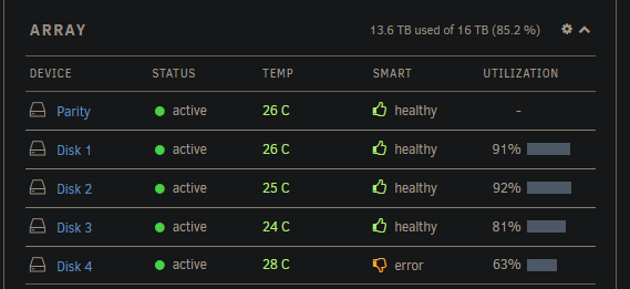

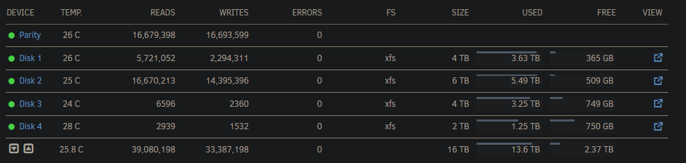

Here's the update today...I ran the server for most of the week in Safe Mode with all plugins and dockers disabled, and the server ran 5 days without restarting.  The first day I re-enabled Plex/Sonarr/Radarr/NZBGet and the server again rebooted overnight.  So tonight I will run only Plex + NetData to see if I have a reboot and if NetData can capture anything relevant.  After @Dking00000's comment, I looked at the drives and while everything looks good on the Main tab:
There is a smart error (thumbs down) for Disk 4 on the Dashboard:
I've attached the log in case anyone can help with this error (and see if it's somehow related to me rebooting issues).

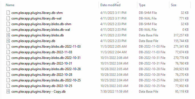

Additionally one thing to look at is the last time Plex was able to backup your database.  The default action (as can be seen in one of my screenshots in an earlier message above) is to do it every three days.  Then it appears to only save the 3 most recent.
Looking at my backup folder it hasn't be able to successfully do that since February.  Which is around the time I began having random issues.  I haven't always had a use for Plex everyday so I sometimes went weeks without turning it on which led me to taking a while to find the issue.
