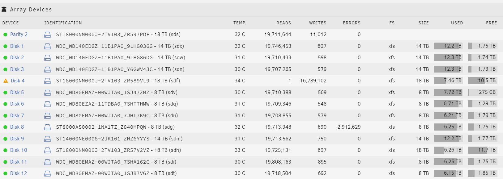

I went to replace one of my disks with a larger disk today and upon rebuild another disk is now showing read errors.  Does this mean the rebuild will fail?  Any help would be appreciated.

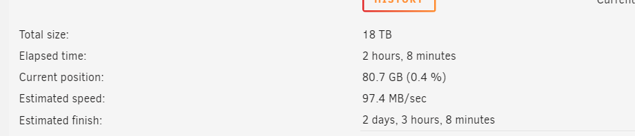

The rebuild seems stuck it hasn't progressed in several hours.  Any help would be welcome!
Disk8 dropped offline, cancel the rebuild, check/replace cables and try again.

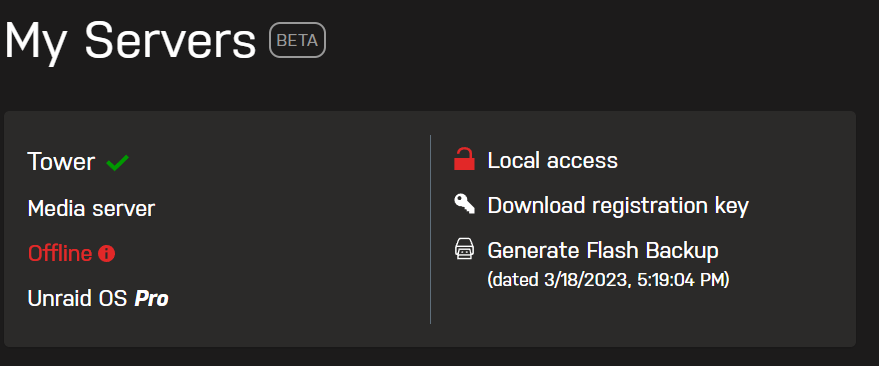

After updating to the most recent copy of Unraid yesterday I performed the My Server backup.  image.png.6206588ff07fdb5354346a0beb094391.png
Edited by Kirkbuilder
So I was able to download the flash backup and install it to a new usb drive and get into the web UI.  It asked me to set the root password and the array is currently stopped.  Is there anything else I should do to retain my configuration or am I good to go?
I think that is all but I could be wrong.    If you have any passwords specified elsewhere then they would also need setting again as the backup process deliberately does not store passwords.
