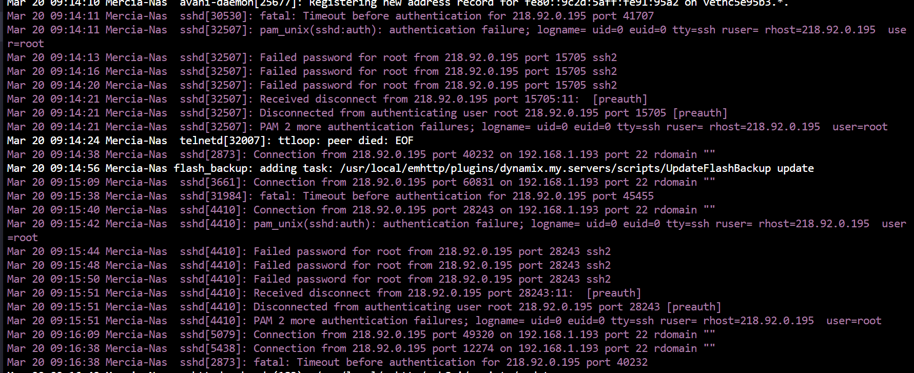

I have repeated email warning saying possible hack attempts.

By exposed I mean inbound connections from the internet being possible.    This can happen if the server is in the routers DMZ.    There has to be something trying to make connections to your server to be triggering the emails.
You should be able to get an idea from the syslog what the source address of the potential hack attempts is which might help pin down the culprit.

ive turned off access to the SSH Port now, that's worrying ! I was hoping it was a docker or an app from my phone !
I do have it in DMZ as i was hoping to get my Searxng Website up and running
You do NOT want an Unraid server to be in the DMZ as it is not hardened against attacks from the web.  Doing so almost inevitably leads to your server being hacked.

I have removed it from the DMZ and Changed the SSH ports to something other then 22 i also have 127 length random password so this should hopefully stop anything.
