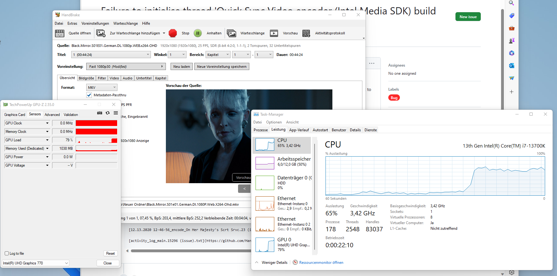

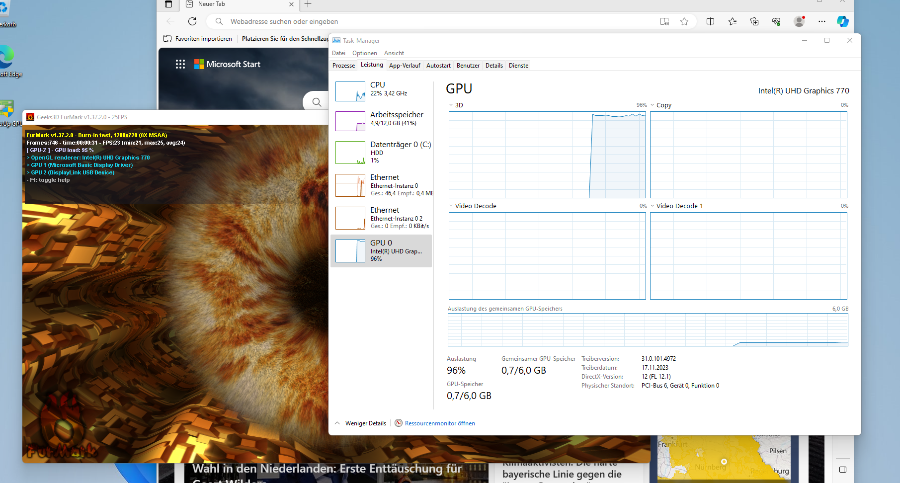

On 11/22/2023 at 10:35 AM, alturismo said:
as the vgpu doesnt start inside the VM, i ll look into HDMI Dummy Test when i find some time ;) didnt found my "dummys" oob yet ... thats the last open point here to look for, rest is looking fine and ok, but ... i ll see and report back if that solved it ;)
Hello alturismo,
I had the same Problems like you, i can not start Parsec or Sunshine because the IGPU was not able to output to an Display. I Try it with an HDMI Display connected, but it was not recognized inside the VM so the GPU can not set as output device. The IGPU has no fault, no error 43 or something, it works and was shown in the Device Manager and as a working GPU in the Task Manager. When i start a Program, like Ungine Heaven, it shows a Load in the Task Manager and also in the GPU Statistics on Unraid so basicly the IGPU was working correctly. A Short test with a Docker Container ( Steam Headless ) was working, it shows the connected Display and works nice. I think the Problem has something to do with the Parstrough to the VM, maybe something is missing so that the Display information was not passing to the VM  / Intel IGPU Driver. I have some more Servers with Nvidia GPU´s (Grid K2, Tesla M10, Tesla P4) but i never seen such Problems with the GPU Pastrough to a VM.
My CPU is a I3-N305 and the System is a Beelink EQ12 Pro

1 hour ago, alturismo said:
just as final feedback, hdmi didnt made it too ;) same result like before.
Ok ok just a final suggestion 🙃 i gues. i  had problems with my 12th gen IGPU i could not use HDMI dummy Plugs and Virtual Displays on that so i use that thing
https://www.amazon.de/gp/product/B076SX73LY/ref=ppx_yo_dt_b_search_asin_title?ie=UTF8&th=1
i pass it to my VM its detected as an Full Blown display WITH HDMI! i can use an HDMI cable now and use it technicly like an Laptop.
I tested it again today and it gives me Parsec, Moonlight (what iam using in those screesnhots) and can use handbrake QSV 265
I had to diable low power qicksync in the Handbrake settings
Edited by domrockt
i know, i tested those with gvt-g too, nice Option when you need a Office solution using the iGPU with a VM, but i removed all and all is fine, was just a simple "testflight" to see how sr-iov performs compared to my gvt-g on UHD630 iGPU.
as mentioned above, not working as expected and actually, no intention for this test with a Displaylink now ;)
but thanks for the Tipp anyway, enjoy your sr-iov VM's, great Solution for the 12th gen up Intel's
