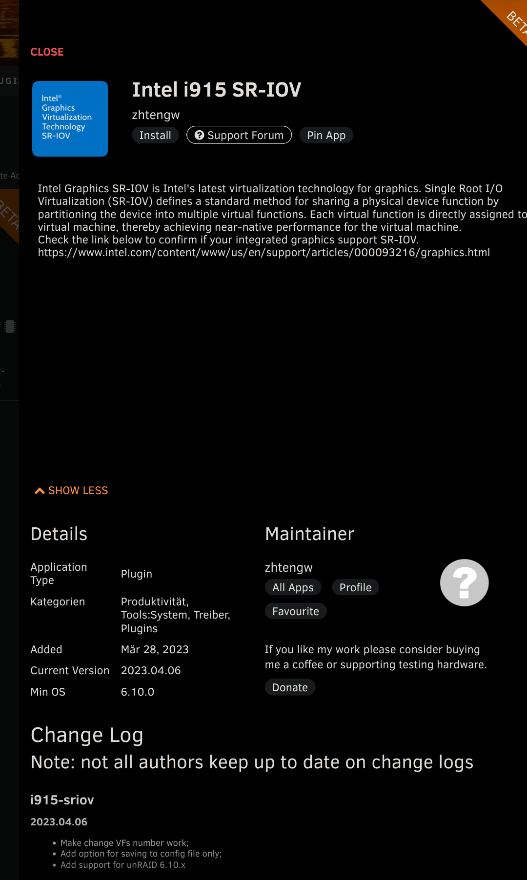

Is this the correct and actually Plugin?
Is ich777 not the new Maintainer or published a new Update for this?
Required the Packet a newer Kernel like from 6.12.5? 6.12.4 don't working.
Edit:
OK, I can see its not in the CA:
When its added to CA?
Edited by Revan335
Maybe never but I'm really not too sure about that, I don't have hardware for that on hand so that I could help people, but as mentioned in the post that you've linked, I would like to give people the chance to still being able to use the plugin, that's why I maintain it now.
That's why the support link points to this thread.

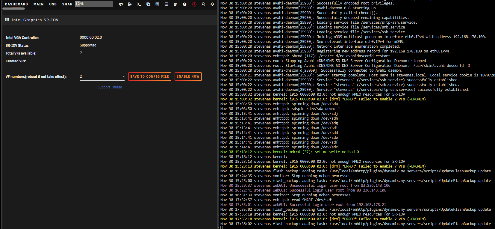

i just try to install it.. its showing up in Device Manager with Code 43.
Since for me things a bit hard to understand, because i am relativ new to this..
What is the right Way to fix this? i was searching in this Tread but nothing helped me :)
Could someone give me a Step by Step instruction for dummys :D
Thanks a lot.
Edit: What i read here is.. that it has to be 00:02.1 because 2.0 is for unraid?
How can i Change this?
there is also no option to Passthrough 00:02.1
Edited by eLpresidente
may take a closer look at the sr iov settings page, there you set the amount of vgpu ... etc ...
Thanks, got errormassage:
and in Syslog this:
Nov 30 17:35:18 stevenas kernel: i915 0000:00:02.0: not enough MMIO resources for SR-IOV
Nov 30 17:35:18 stevenas kernel: i915 0000:00:02.0: [drm] *ERROR* Failed to enable 2 VFs (-ENOMEM)
Tried to Reboot like in the Plugin mentioned.. but still not able to Change it

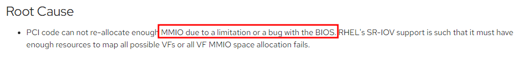

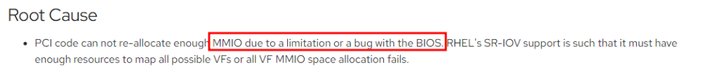

i am sorry to border you, but for me the Solution https://access.redhat.com/solutions/37376 is hard to understand.
i am absolutly new to this sorry for asking maybe stupid questions, but never have worked with or on Linux  Based systems..
As a workaround solution, one can pass "pci=realloc" to kernel 2.6.32-228.el6 during booting.
1. do i have to write "pci=realloc" in the go File?
Append the following parameters "intel_iommu=on pci_pt_e820_access=on pci=assign-busses" to the kernel line in grub,conf,
3 , If it is a xen kernel, append iommu=1 msi=1 to xen kernel line (also include the above parameters to the kernel line),
4,options igb max_vfs=XX in /etc/modprobe,conf,
2. same for this ?
3. or do i habe to write all of this in here?

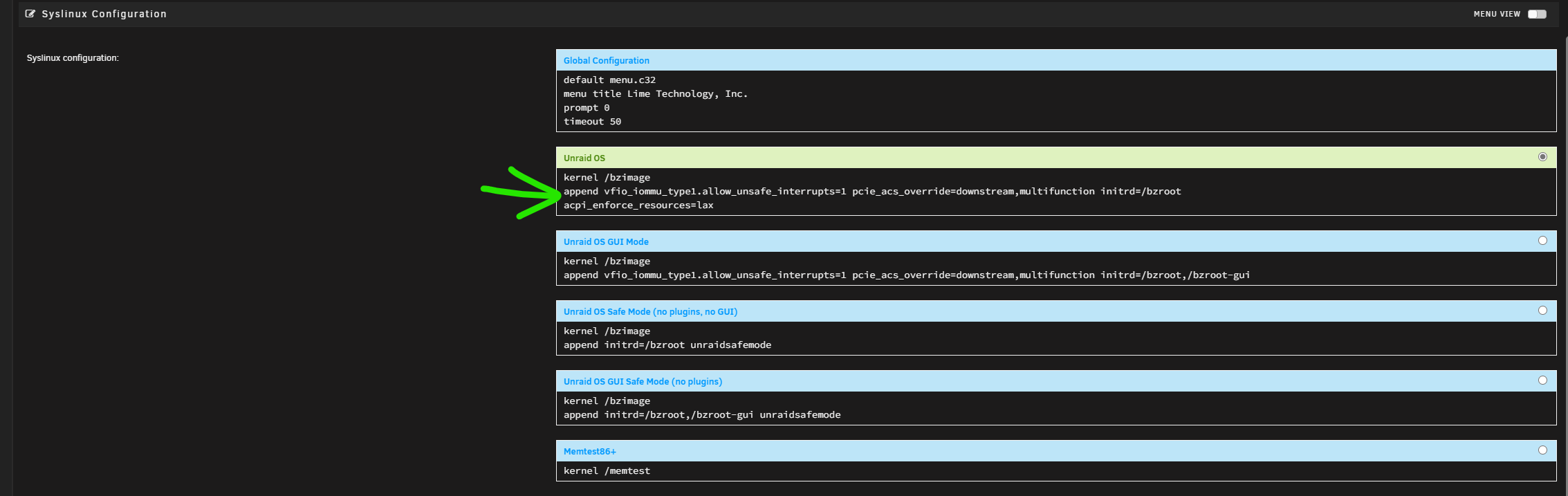

Before:
kernel /bzimage
append vfio_iommu_type1.allow_unsafe_interrupts=1 pcie_acs_override=downstream,multifunction initrd=/bzroot
acpi_enforce_resources=lax
After editing this:
kernel /bzimage
pci=realloc
______________________________________________________________________________________________________
4. And make a modprobe.conf with nano and put in "igb max_vfs=XX" <-- here for XX then 2 if i need 2 VFs ?
in short, drop it ...
you can try the mentioned workarounds ... but dont expect any support therefore ... most likely its a hardware limitation ...

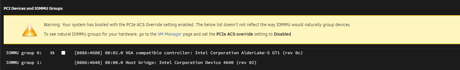

may i ask why you enabled all this ... ;) actually this is offtopic here now, but most likely often also not helpful ...
its a "hard" workaround to split iommu's ...
Oh okey i see, i thought you can workaround this with pci=realloc
You May.. i guess its from the Start of my UnraidFight :D watching YouTubeVideos and dont understand shit what i am doing :D.. just click the same stupid shit what they show us.. :D i learned that this is not the best way.. but i guess this is still left from that..
My VM IOMMU Groups is split in Both.. i guess this came from that right?
I'll now diable it and try again..
but was the way what i wrote up there totaly wrong?

This article is for network cards not GPUs, and it's for a very old kernel (2.6.32). Checking if there's a BIOS update is a good idea though. Your BIOS may have limitations that prevent SR-IOV from working.
you are correct, but thats only 1 hit from google which i took now and in the end, ressource issue is the same ;)
and of course, updating bios could help, reverting his iommu pci aes override's could help, pray could help ;)
whenever i read about this error ... its the same road, compared to gvt-g vram issue and Bios implementations ...
nothing you can do about it from outside (standard way".
if you have any support for him how he can resolve it, go ahead ;) i couldnt find anything reliable.
