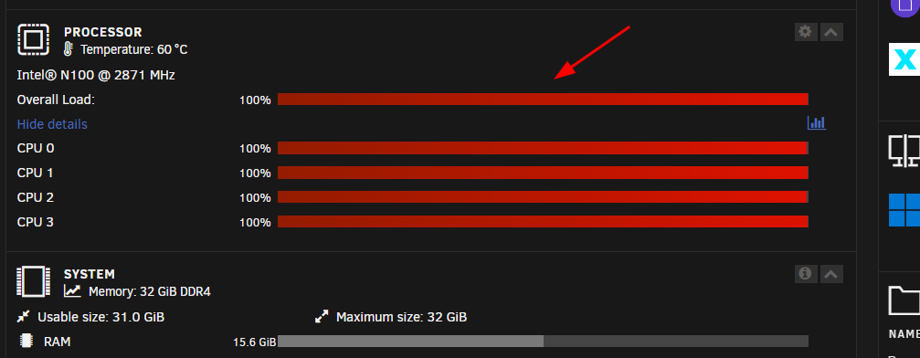

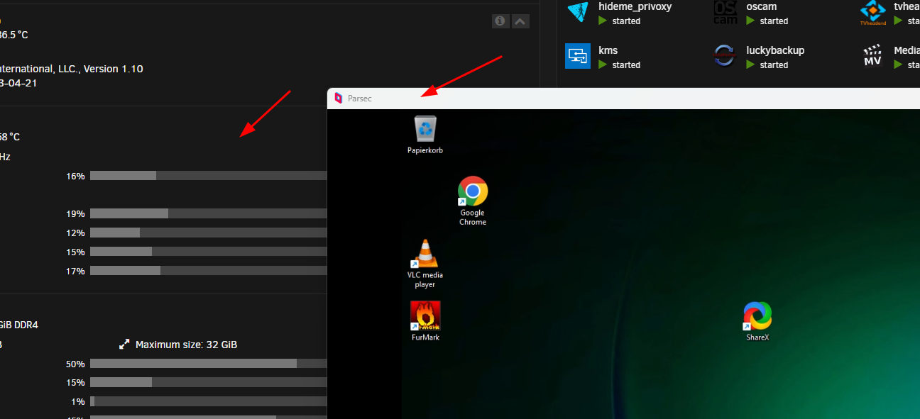

thanks alot for the "wink", tested here now and yes, also working here on the n100 platform now, same behaviour as gvt-g with hw de/encoding, very nice and thanks sgain, this made me fire up the plugin and the vm again to give it a try ;) and worked out ;)
may 1 addition i see here, while connected to the VM everything is smooth and running fine, but once i quit the connection and the VM is in idle ... CPU usage is increasing to 100 % here.
Once i reconnect to the VM (either way, Parsec, VNC, ...) the VM returns to normal state and CPU usage is back to normal again.
just as note from my side here
in use
disconnected and in idle
