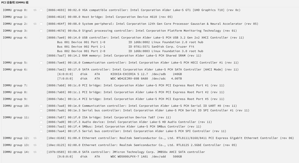

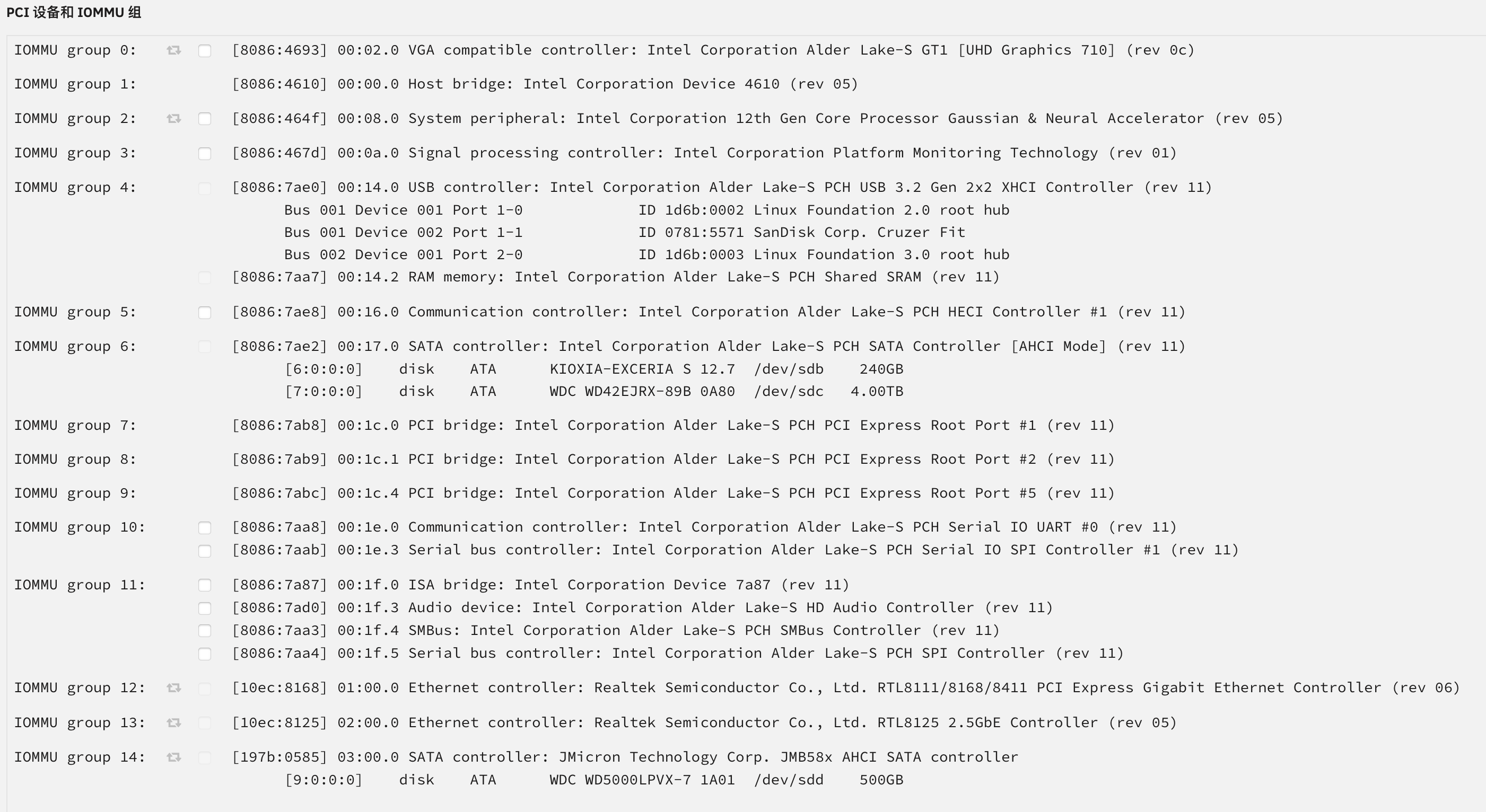

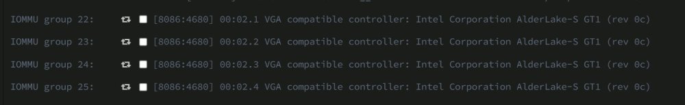

我刚刚把系统升级到了6.12 rc2,安装了插件,也显示安装成功并重启了,但是并没有看到vf设备呢?
铭瑄h610itx+12100
ls/dev/dri好像是能看到三个显卡,但是设备里看不到105BC5D9-164F-4DF5-A644-7285DFFE5449.thumb.png.8ee551b548c54a812cd7cfd86cf73ac9.png01F6F7BC-44AB-49BB-A108-B71F1F54CA45.thumb.png.17bcac7092cb7d8d50891743e376d706.png
有的,最后两行就是

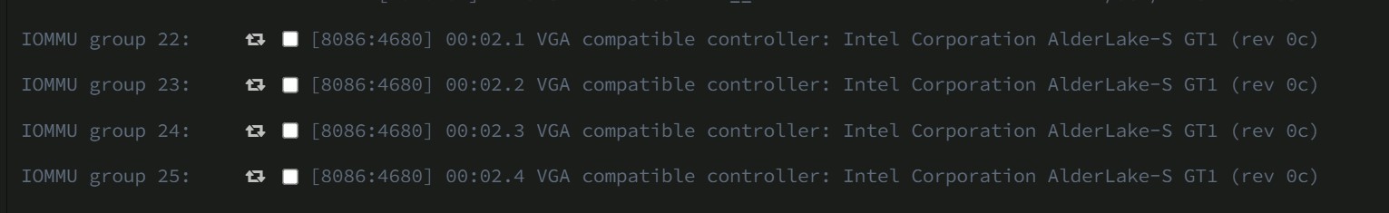

so i  tested some more... i cant get it to work on boot.. idk why. could there be something wrong  with my go file?
when i add "echo 4 > /sys/devices/pci0000\:00/0000\:00\:02.0/sriov_numvfs" manually i have my 4 FVs when stubbed already to use.
But when i reboot they are gone and i need to put in "echo 4 > /sys/devices/pci0000\:00/0000\:00\:02.0/sriov_numvfs" manually.
i mean a cron on startup will do the job but strange enough.

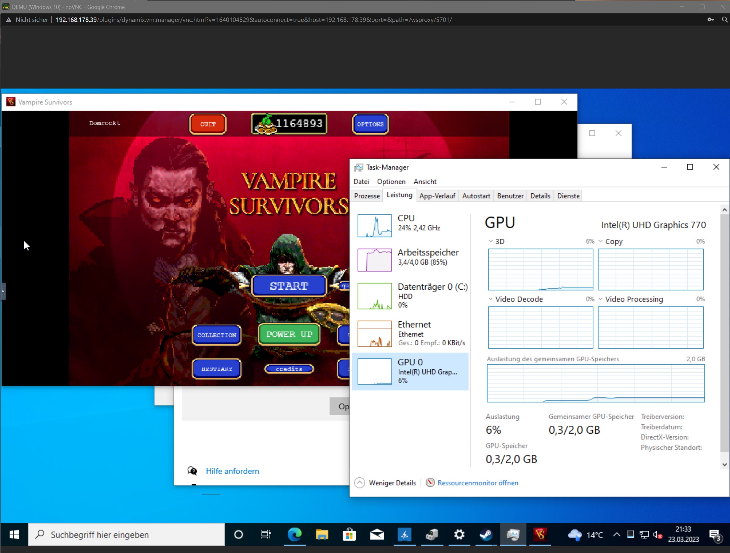

So i spun up an test VM win 10
I did
1) in Bios enable sriov
2) Intel GPU TOP
3) install i915-sriov Plugin from the link (for now) you provide
4) add the ammount of FVs in the go file , echo 4 > /sys/devices/pci0000:00/0000:00:02.0/sriov_numvfs
5) I need to make an userscript cron on first boot array "echo 4 > /sys/devices/pci0000\:00/0000\:00\:02.0/sriov_numvfs"
5) reboot
6) The PF (00:02.0) could be used by Unraid host. And the VFs(00:02.x) are only used for passthrough to VMs
7) install any VM
8 ) install the intel driver (Linux) or gibe the VM some time Windows update gets the driver on its own.
Edited by domrockt

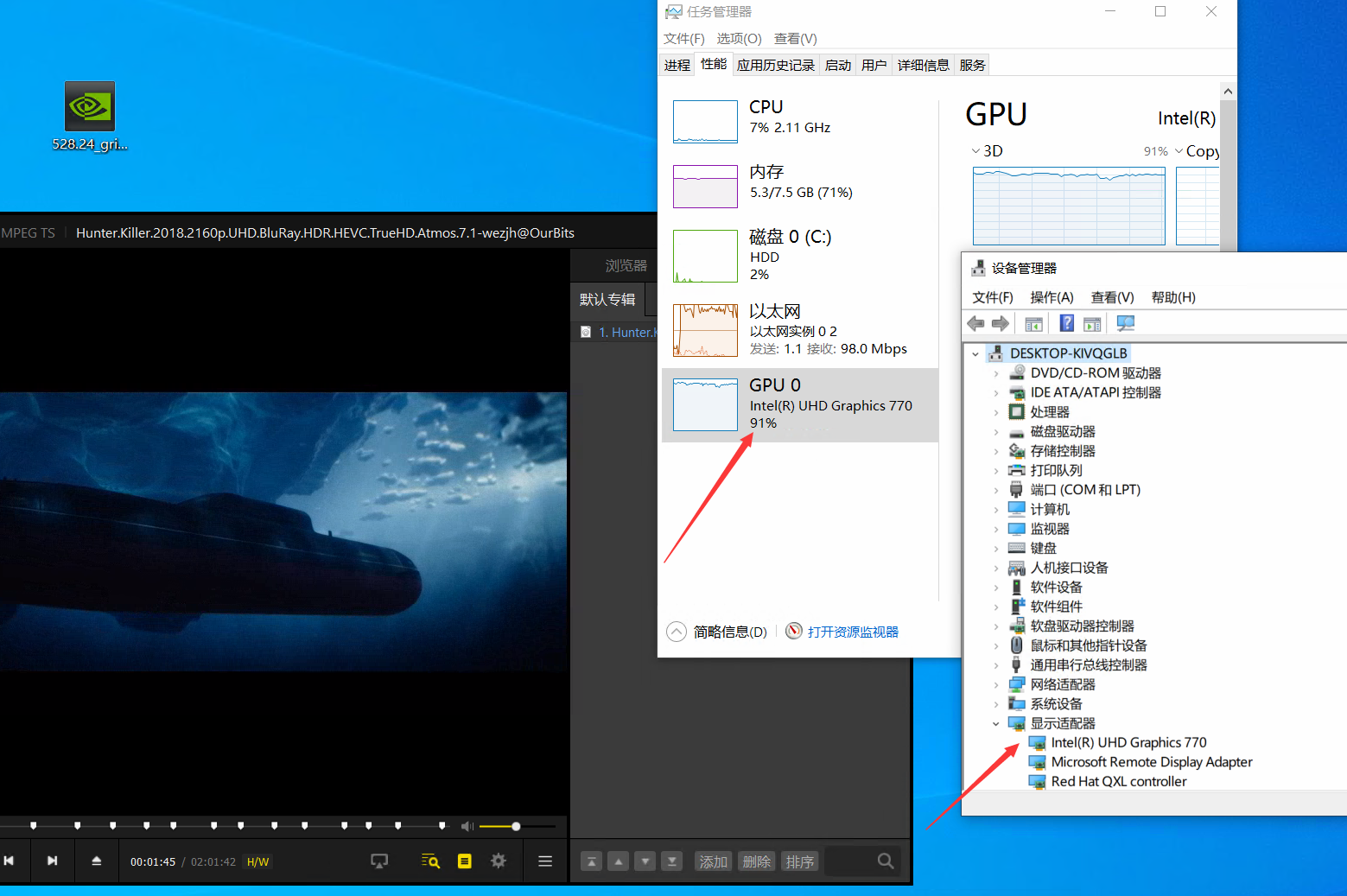

12代CPU完美虚拟化,完美解码4K高清原盘。但是存在一个问题导致Docker 容器jellyfin硬解不显示画面。

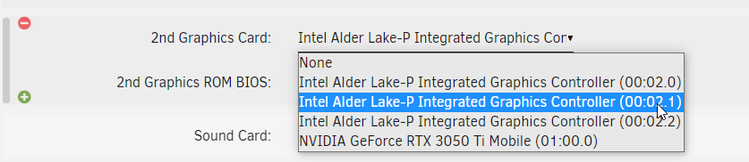

The plugin made it possible to have a working GPU without code 43 in a Windows 11 VM.
Previously, when I selected 00:02.0 video card, the screen on the laptop went from Unraid Console output to black, and I could RDP into Windows. But no screen output on the laptop. This gave me the Code 43 and a message in the log stating that it couldn't find a ROM.
When I select 00:02.1 the laptop's screen remains to outputs the Unraid console output.  Within Windows 11 (via RDP) I can see that video card is working (no more Code 43).

[   51.999454] i915 0000:00:02.0: [drm] Missing GuC-Err-Cap reglist Class(1):Compute(4)!
[   51.999455] i915 0000:00:02.0: [drm] Missing GuC-Err-Cap reglist Instance(2):Compute(4)!
[   52.002178] i915 0000:00:02.0: [drm] HuC authenticated
[   52.002665] i915 0000:00:02.0: [drm] GuC submission enabled
[   52.002665] i915 0000:00:02.0: [drm] GuC SLPC enabled
[   52.002974] i915 0000:00:02.0: [drm] GuC RC: enabled
[   52.003523] i915 0000:00:02.0: [drm] Protected Xe Path (PXP) protected content support initialized
[   52.004197] [drm] Initialized i915 1.6.0 20201103 for 0000:00:02.0 on minor 0
[   52.011018] i915 0000:00:02.0: [drm] Cannot find any crtc or sizes
[   52.011092] i915 0000:00:02.0: [drm] Cannot find any crtc or sizes
# cat /sys/devices/pci0000:00/0000:00:02.0/sriov_numvfs
0
手动执行 echo 2 > /sys/devices/pci0000:00/0000:00:02.0/sriov_numvfs,提示 -bash: echo: write error: Numerical result out of range
可以帮我看看问题出在哪里吗。
4 minutes ago, 涼風桜雨 said:
G6900,UHD710,铭瑄H610M,插件版本2023.03.28
# dmesg | grep i915
[   51.865531] i915 0000:00:02.0: [drm] VT-d active for gfx access
[   51.865556] i915 0000:00:02.0: vgaarb: deactivate vga console
[   51.865592] i915 0000:00:02.0: [drm] Using Transparent Hugepages
[   51.866176] i915 0000:00:02.0: vgaarb: changed VGA decodes: olddecodes=io+mem,decodes=io+mem:owns=io+mem
[   51.869710] i915 0000:00:02.0: [drm] Finished loading DMC firmware i915/adls_dmc_ver2_01.bin (v2.1)
[   51.997243] i915 0000:00:02.0: [drm] Missing GuC-Err-Cap reglist Class(1):Compute(4)!
[   51.997247] i915 0000:00:02.0: [drm] Missing GuC-Err-Cap reglist Instance(2):Compute(4)!
[   51.998655] i915 0000:00:02.0: [drm] Missing GuC-Err-Cap reglist Class(1):Compute(4)!
[   51.998657] i915 0000:00:02.0: [drm] Missing GuC-Err-Cap reglist Instance(2):Compute(4)!
[   51.999016] i915 0000:00:02.0: [drm] GuC firmware i915/tgl_guc_70.bin version 70.5.1
[   51.999018] i915 0000:00:02.0: [drm] HuC firmware i915/tgl_huc.bin version 7.9.3
0
可以帮我看看问题出在哪里吗。
你好,可以看看“cat /sys/devices/pci0000:00/0000:00:02.0/sriov_totalvfs” 和 “lspci -vs 00:02.0 ” 这两个命令的输出吗?
# cat /sys/devices/pci0000:00/0000:00:02.0/sriov_totalvfs
0
# lspci -vs 00:02.0
00:02.0 VGA compatible controller: Intel Corporation Alder Lake-S GT1 [UHD Graphics 710] (rev 0c) (prog-if 00 [VGA controller])
        DeviceName: Onboard - Video
        Flags: bus master, fast devsel, latency 0, IRQ 138, IOMMU group 0
        Memory at 90000000 (64-bit, non-prefetchable) [size=16M]
        Memory at 80000000 (64-bit, prefetchable) [size=256M]
        I/O ports at 5000 [size=64]
        Expansion ROM at 000c0000 [virtual] [disabled] [size=128K]
        Capabilities: [40] Vendor Specific Information: Len=0c <?>
        Capabilities: [70] Express Root Complex Integrated Endpoint, MSI 00
        Capabilities: [ac] MSI: Enable+ Count=1/1 Maskable+ 64bit-
        Capabilities: [d0] Power Management version 2
        Capabilities: [100] Process Address Space ID (PASID)
        Capabilities: [200] Address Translation Service (ATS)
        Capabilities: [300] Page Request Interface (PRI)
        Capabilities: [320] Single Root I/O Virtualization (SR-IOV)
        Kernel driver in use: i915
        Kernel modules: i915
0
# lspci -vs 00:02.0
很遗憾,totalvfs显示是0,赛扬这个U虽然支持SR-IOV功能,但可用的vf是0,分配不出来虚拟显卡。
感谢解答,以后升级一下CPU
