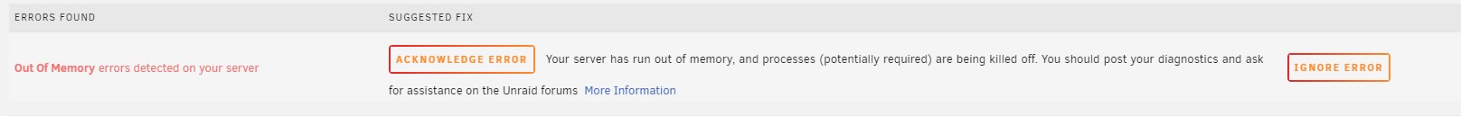

The Fix Common Problems plugin is reporting that Out Of Memory errors are detected on my UNRAID server.

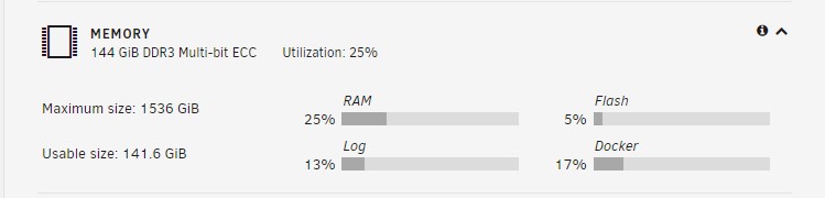

This server has 144GB of RAM and as it is mostly used for storage only 25% of the RAM is actually used.

Can you explain some more on this point please? As I have less than 25% utilization of RAM on this server (over 100GB RAM free) it would be strange for fragmentation to occur, this normally only occurs when RAM usage is getting over 50%. A quick look at top shows over 104GB is used by cache and this gets reallocated as application RAM as needed.

So the warning from Fix Common Problems about "Your server has run out of memory..." is a bit misleading (and overly worrying). Perhaps Fix Common Problems can detect this as a different kind of error and report "Your container X has run out of memory..."
