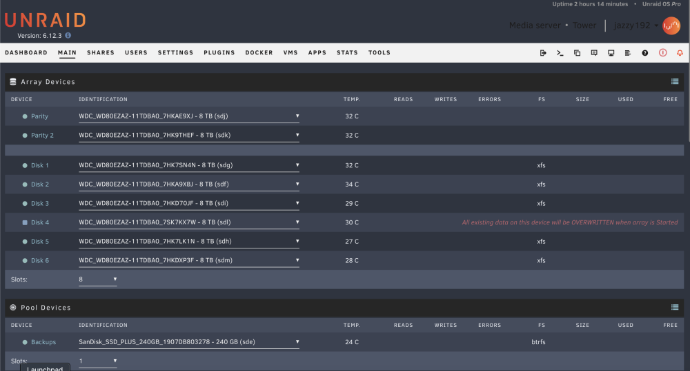

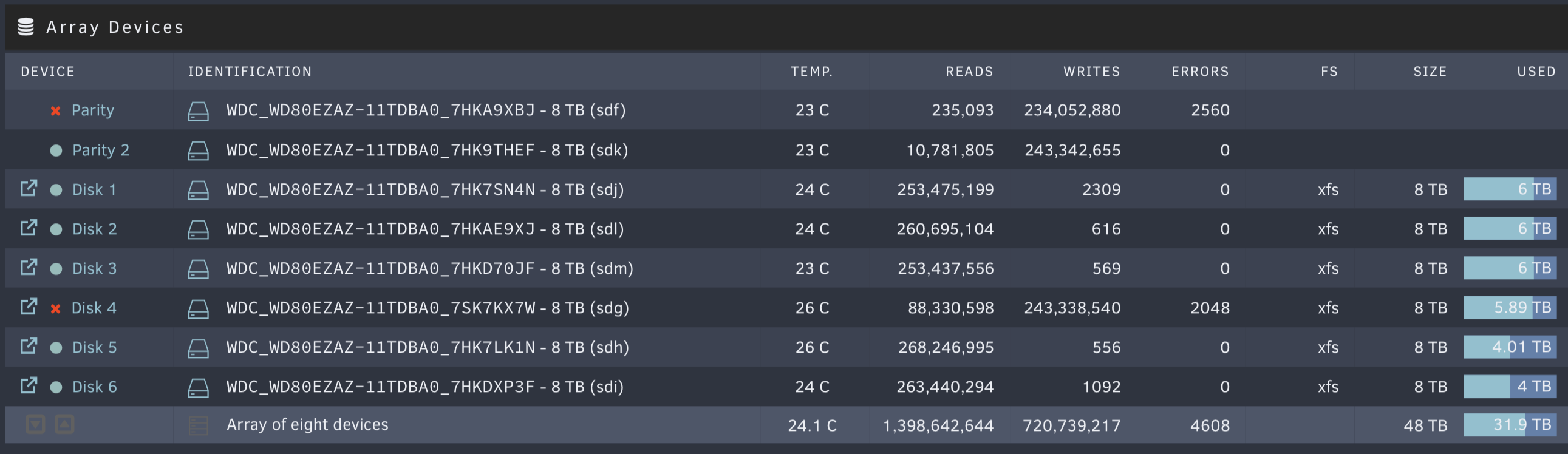

Never had any disk errors before apart from cache had a few but still fine. Never any on my array discs. Not sure if it's related but I upgraded to 6.12.0-rc2 a few days ago. Had some files on my cache so evoked mover and then loads of errors came up on Parity disk 1 and now disk 4. Not sure if it's related to the update.
All my array disks are WD Reds.
It's just doing a read test now and looks like it's going to take a few hours but have attached logs for both disks now as at first, it was just disk 1. Also attached are the diagnostics logs.
Cheers

Looks more like a power/connection problem, check/replace cables, also btrfs is detecting a lot of data corruption, you should run memtest.

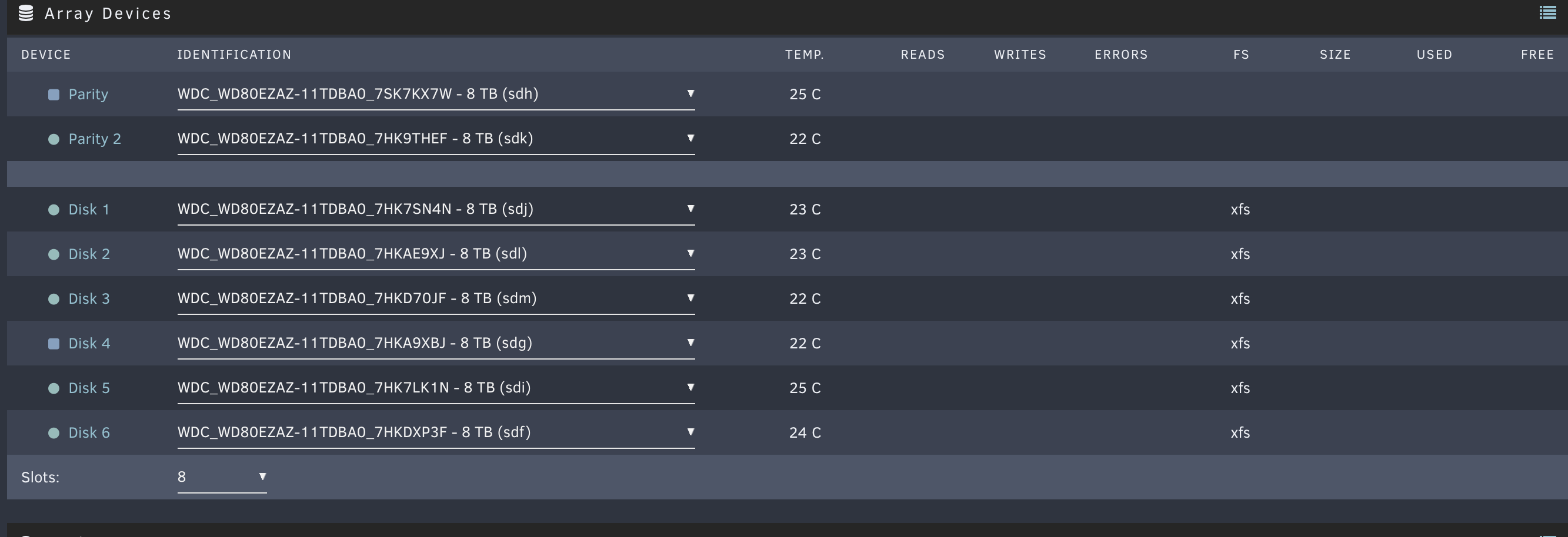

Cheers, I was just finishing that when noticed my array discs have moved around. Is that normal? I cannot put the same disk back in Parity one as the only one unassigned after assigning the other back is already in the array compared to my last screenshot?!
Not sure I follow, post a new screenshot of main.
This is two days ago and just now attached.197483867_Screenshot2023-03-21at02_50_43.thumb.png.6a316e0f2773cc380d054fa3a4afb353.png
They wouldn't swap on their own, but for this case it doesn't matter.
I didn't swap them and no one else apart from my partner has access?
Don't see how, but post new diags, in the last ones they were still assigned as the first screenshot.
Honesty Jorge, I have no reason to mix them up! It Paused rebuilding to do a read check, shall I let that complete or rebuild firsT?
