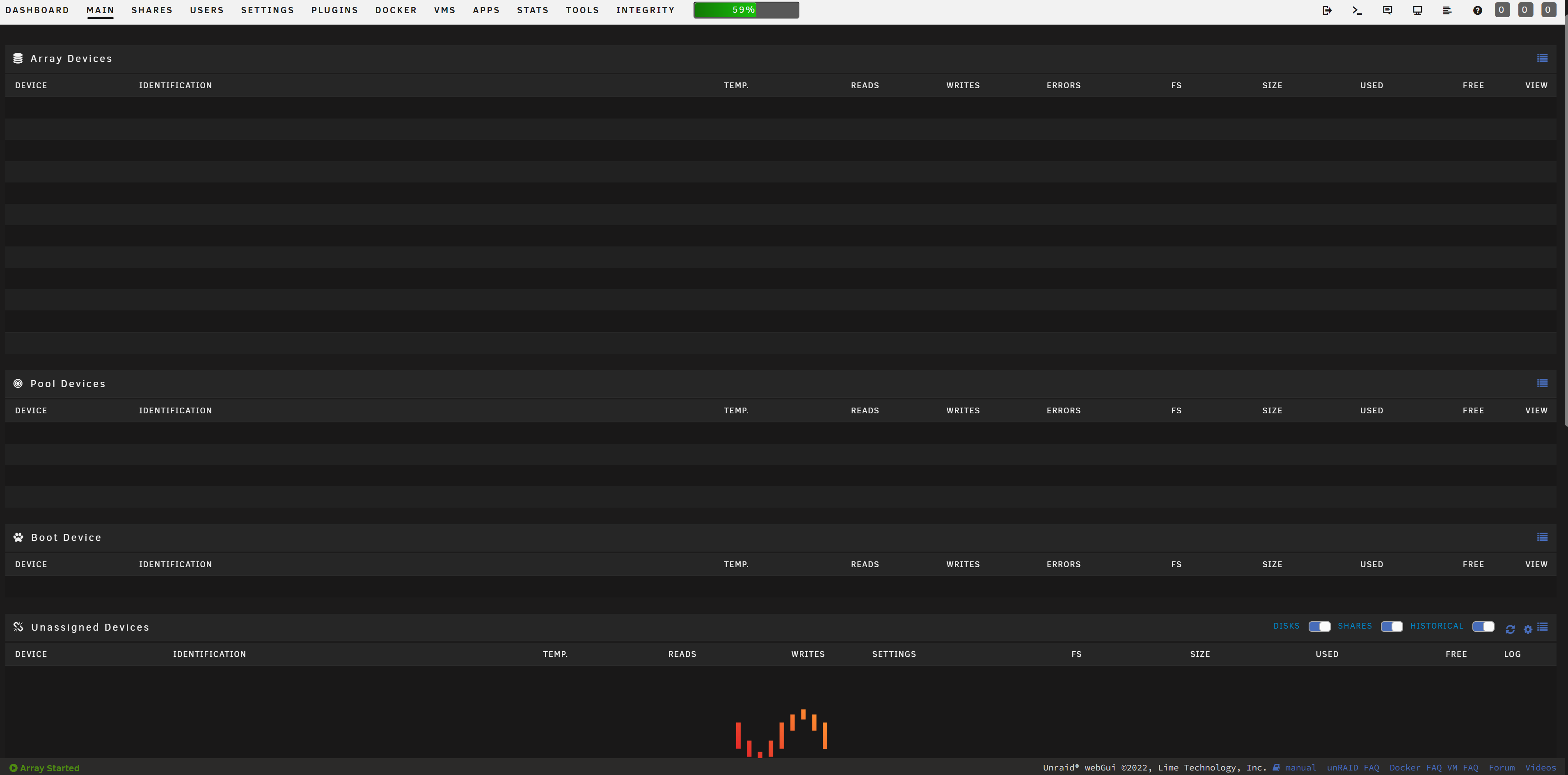

March 21, 20233 yr I attached a screen shot. My server was on 24/7 except for restarts and updates for a few years and then I moved somewhere with expensive power and only turned it on every once in a while. I just started leaving it on 24/7 again recently and have noticed that the GUI gets stuck as shown in the screenshot fairly often. It'll sit like this for 5 or 10 minutes or longer, I haven't timed it but it's much longer than normal. Sometimes I'll stop & start the array and it'll work normally for a while, maybe less than an hour before it happens again. Does anyone have ideas for what might be causing this or how to fix? Let me know if there's any additional info I can provide.

March 22, 20233 yr Same here. This happens at random intervals. A server reboot is the only solution. When I open the logs it shows nothing, it does not populate like the rest.
April 26, 20233 yr Any solution to this. This keeps happening after a few weeks. Only solution is a reboot.
July 17, 20233 yr I have the same issue and have had it on 6.11 and now 6.12. I have found loading unraid in an incognito window (chrome and brave browser, not sure about other browsers) solves it and the GUI loads fully. However I have no idea what the cause is. Also, a while (as in, an hour or so) later it happens again, in the incognito mode window. Opening a different incognito window solves it again, for a while. It looks exactly the same as in your screenshot and in my case it appears (though I am not certain) to happen more often when the server is under load. Also, like Gabriel_B mentions, my syslog window also doesn't populate when those parts of the GUI aren't populating Edited July 17, 20233 yr by BlueBull

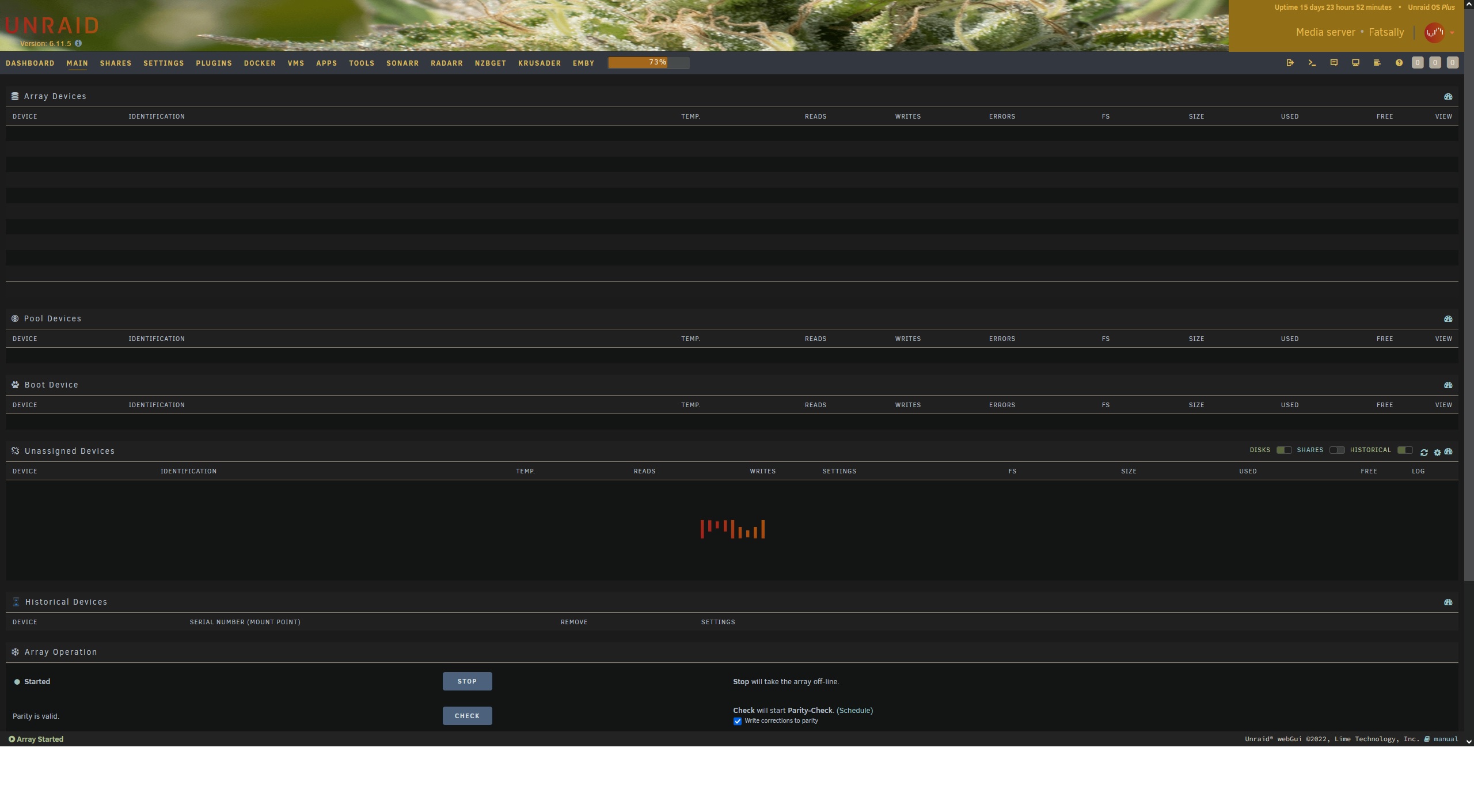

December 10, 20232 yr I'm having the same issue. Never had this issue in past. All the dockers working fine, just cannot see any diagnostics regarding my drives, server etc.. have not reboot it yet. anyone figure out the cause?
December 11, 20232 yr will try with a edge browser, but did not work with chrome incgnito mode or safari.
