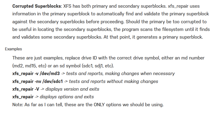

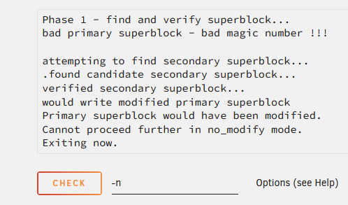

I read through the link you sent and due to my File System being XFS I ran the check with the parameters -nv.
I got the following output:
If I understand this correctly the command says it would write a modified primary superblock.
Is it correct that the way to move forward from here is to execute the Check again with the "-v" parameter alone?
Information that are linked to the shown error:
I apologize in advance for asking any small step but I just want to be absolutely certain I do not damage the files that might still be on the disk.
Correct, and if it asks for -L use it.

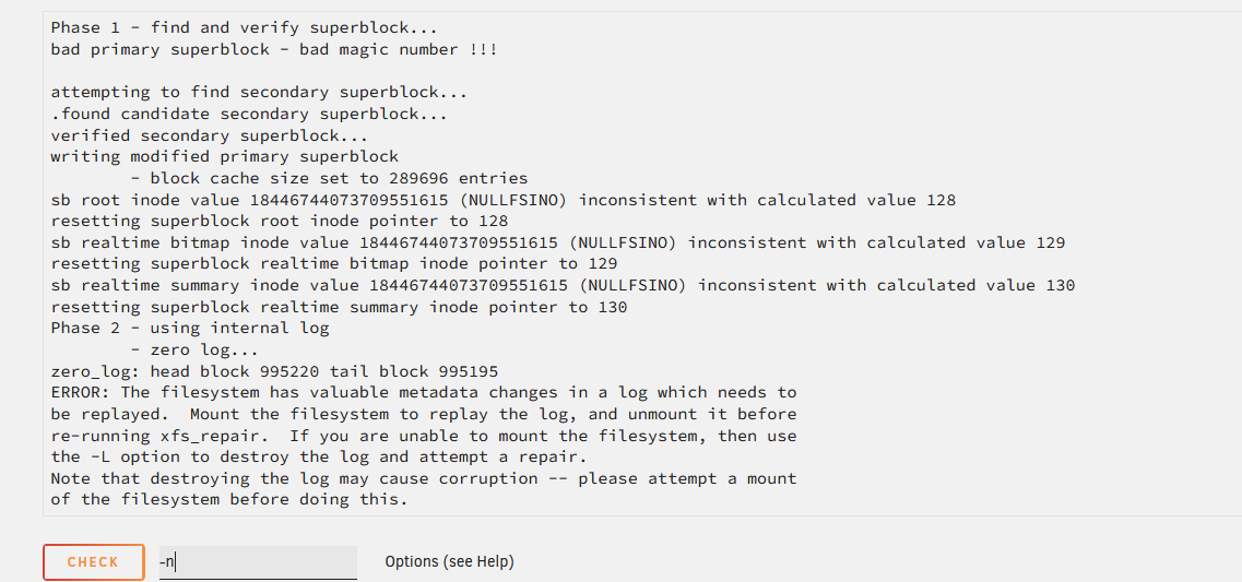

I ran the -v and got this:
As you already correctly predicted this message I am now to not follow the advice of the "mount, replay the log, unmount it" but rather run it directly with "-vL"
For other people in the future link to a different topic that explains why its okay to run "-L" to delete the log:

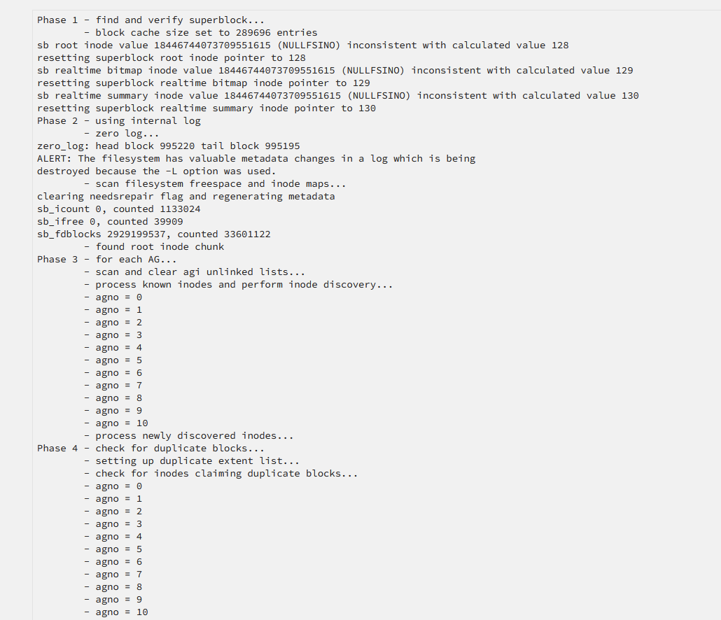

I am gonna run that now and report back afterwards

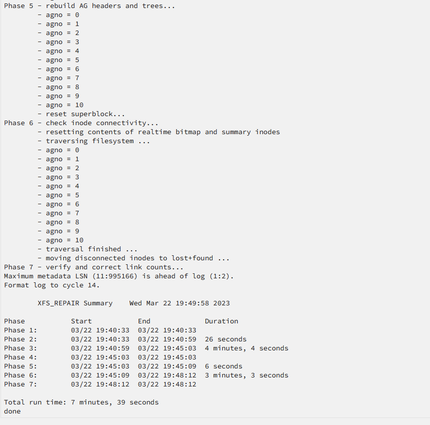

Ran the command sucessfully. For documentation if other users ever need it:
However the disk still shows like this:
