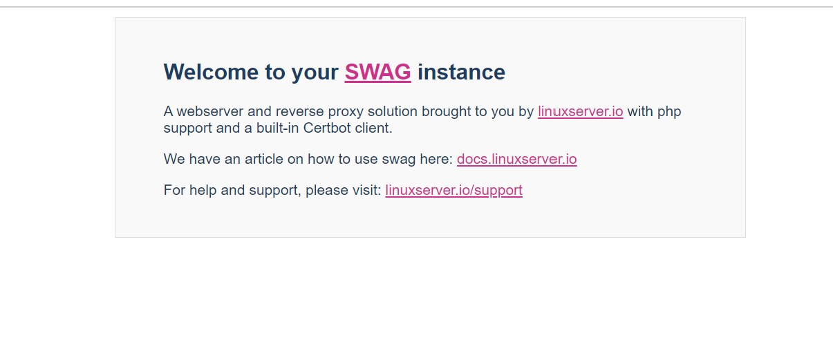

I've spent the better part of the last 16 hours attempting to run through this guide:
https://emby.media/community/index.php?/topic/94566-guide-setup-emby-with-hw-transcoding-on-unraid-remote-access-through-reverse-proxy-using-swag/
I have followed everything to the letter half a dozen times, but when I get to the very end and attempt to test the domain, I get this message (pic attached) on the screen, where as it should be going directly to the Emby login page.
Can anyone help to troubleshoot why I'm having this issue? I'm at my wits end and have been troubleshooting and retrying this for the last 12 hours with no luck.
Diagnostics log is also attached.
maverick-diagnostics-20230323-1222.zip
Thats the screen that defaults for your domain once swag is setup.  Did you setup a subdomain for emby?  Did you edit the emby.subdomain.conf.sample file in SWAG and rename the file to emby.subdomain.conf with any edits that may be required?

So "yourhostname".hopto.org will show you the swag screen.  When you type in emby."yourhostname".hopto.org (or whatever your subdomain is) it still takes you to the swag screen?  When you look in the SWAG log did it issue an ssl certificate for emby?

If I try to go to emby.XXXX.hopto.org it just comes back saying “ip address cannot be found”, vs if I go to XXXX.hopto.org I still get the swag screen.
