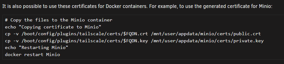

Hello!
I used the script on the help tab to get an HTTPS cert working for my webgui. All good.
Now I'm trying to copy the cert over to some docker containers to get HTTPS on more of my services, following the steps on the help tab. I'm new to this kinda thing, so bear with me, but once copied over, how do I get the certs working? The instructions end and that's where I (a newbie) gets lost.
Thanks in advance!

10 hours ago, marklevark said:
Hello!
Thanks in advance!
This isn’t something that I can really help with, you’d have to refer to the documentation for the containers to see how to replace the certificate that each uses.

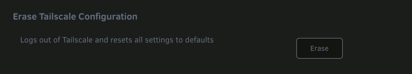

Might need to try it out, how do you erase the config?
Plugins > Tailscale > Settings tab

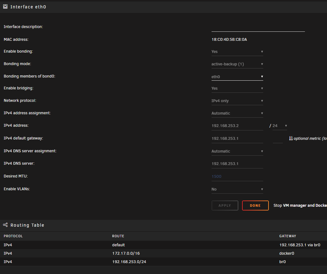

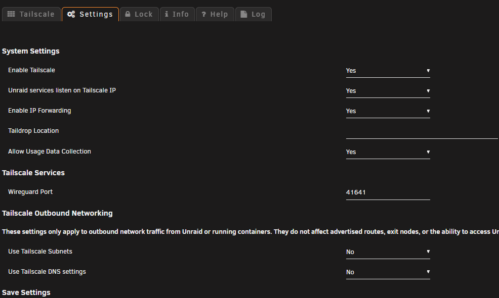

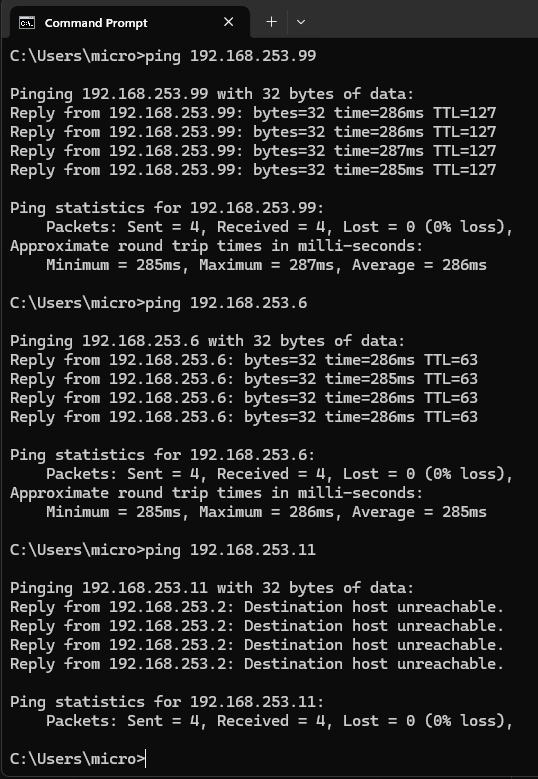

I setup tailscale to push routes, and I can ping physical computers and virtual machines, but not any docker containers?  I imagine thats largely because the dockers don't have MAC addresses due to being on ipvlan?  How can I make it so I can ping/access web gui of docker containers.
.99 is a VM on the unraid server running tailscale.
.6 is another unraid server on the same physical network.
.11 is a nextcloud docker on the unraid server running tailscale.
Is it because my br0 docker network is the same network as my physical network? (See third screenshot)
Edited by ISOT
Ok disregard.  Enabled "Host has access to custom networks" in docker config, working now.  8 year unraid user, feel dumb now.
