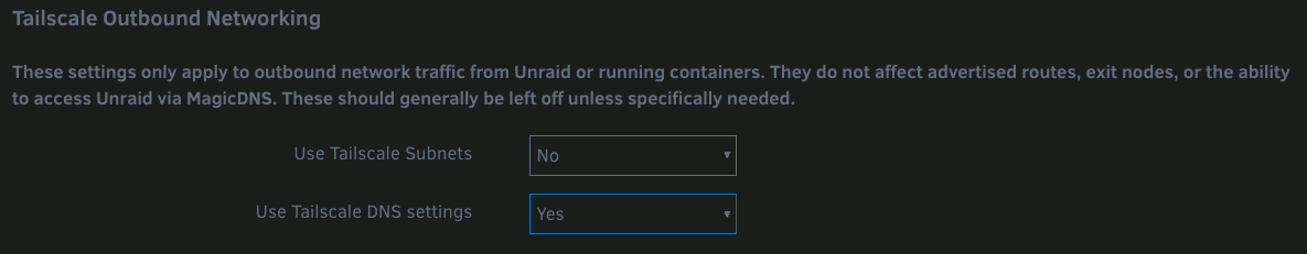

Here's the Tailscale advanced setting "Tailscale Outbound Networking"
Use DNS is set to Yes by default. It might be a good idea to default this to No if the issue of not using upstream/global DNS can't be fixed in the plugin.

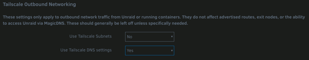

The default setting is No:
