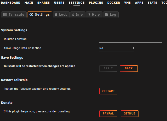

The main dashboard and settings page is still not loading for me using the Preview version. This is from a clean install where I deleted any Tailscale references from the /boot/config directory and rebooted.
Tower-tailscale-diag-20241020-175615.zip
