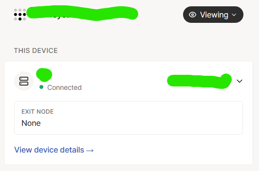

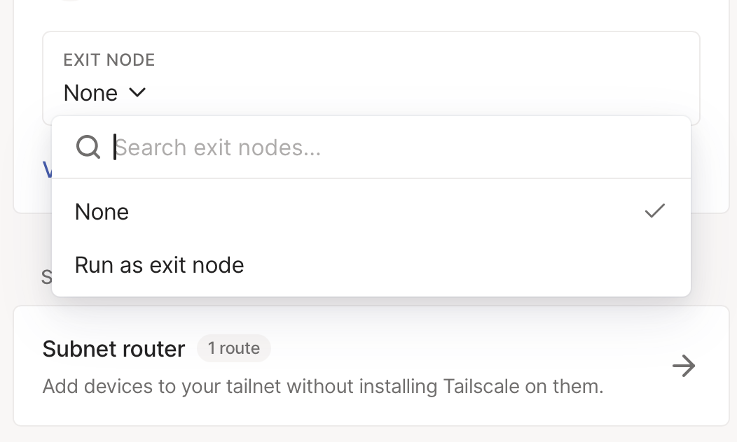

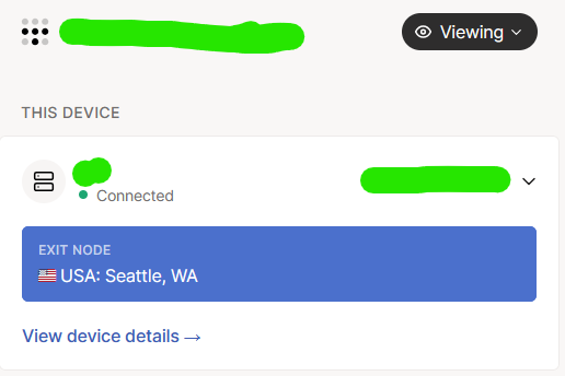

This may be a dumb question, but I recently signed up for the Mullvad add on and for some reason I can't select any exit nodes on the Tailscale plugin GUI ...there doesn't seem to be any drop down options:
I have confirmed that the Mullvad option is added to this device and I can enable it using the terminal (via this command: tailscale set --exit-node=<exit-node-ip> --exit-node-allow-lan-access=true):
Wondering if I am just missing something? I have tried disabling/enabling the plugin, as well as resetting it but same thing.
EDIT:
Okay so I am dumb haha ... turns out i was NOT connected to Tailscale on my local PC accessing the unraid interface.  I connected to Tailscale on my PC and under the "viewing" drop down able to auth and see the drop down for exit node.
However, it does not seem to be showing any Mullvad exit node options; confirmed via terminal that i can see and connect to the Mullvad exit nodes.  So i think it's same issue as @ulischultz posted in this thread
Edited by stansz

Same for me. I believe that’s by design and it requires command line to select an exit node.
Here's a command that will give you the fastest exit node for your area:
tailscale exit-node suggest

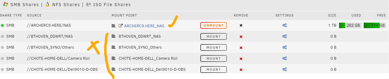

Just installed tailscale plugins. Set network bios to no. While my tailnet devices can now see all SMB drives on other devices, the "SMB Shares" on Unraid can no longer see smb share by device names. Instead, unraid can see those devices only by their hostnames as defined on my pfsense static IP setting.
Is it a normal behavior when running tailscale on unraid?
Please follow the instructions in the pinned post and provide Tailscale diagnostics.

If you click where it says "Viewing" in that picture, it will open an option to sign in. You can then use the web interface to select an exit node.
