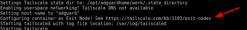

Settings Tailscale state dir to: /opt/adguardhome/work/.tailscale_state
Enabling userspace networking! Tailscale DNS not available
Setting host name to "AdGuard"
Configuring container as Exit Node! See https://tailscale.com/kb/1103/exit-nodes
Starting tailscaled with log file location: /var/log/tailscaled
Starting tailscale

Actually I only need a tailscale exit node on my unraid.
I wanted to use my unraid itself as exit node, but it does not work, as I mentioned above.
So I thought I just install tailscale in the AdGuard Container and use this as exit node.
If I could use unraid as exit node, I would not need any tailscale in the AdGaurd container at all.

First because I really don't want to give anyone accidentally access to my server (I never know what I might configure wrong... :D ) and another benefit from using the Unraid Tailnet Docker integration is that you can use Serve and access all containers individually over https.
4 minutes ago, ulischultz said:
If I put the tailscale IP of my adguard container here in the tailscale DNS settings as global nameserver it stops working.
I think you are referring to that:
I think you can't use a Exit Node as DNS but I've never tried to use a Exit Node as DNS.
BTW I removed the image from your previous post since you've exposed your MagicDNS.
Ok, thank you!! So you say that using the tailscale docker container instead of the new unraid plugin is still the better way?
Not really, this is personal preference and always depends on the individual user.
TBH I think I do many things differently than most other users... :D
It's not a one-or-the-other thing.
The plugin gives you access to the WebGUI/NFS/SMB/bridged containers.
The docker method lets you create unique Tailscale machines for different containers, which is useful if you want to share them with other people (but not your whole Unraid server).
You can use either, or both, it all depends on what you want to do :)
