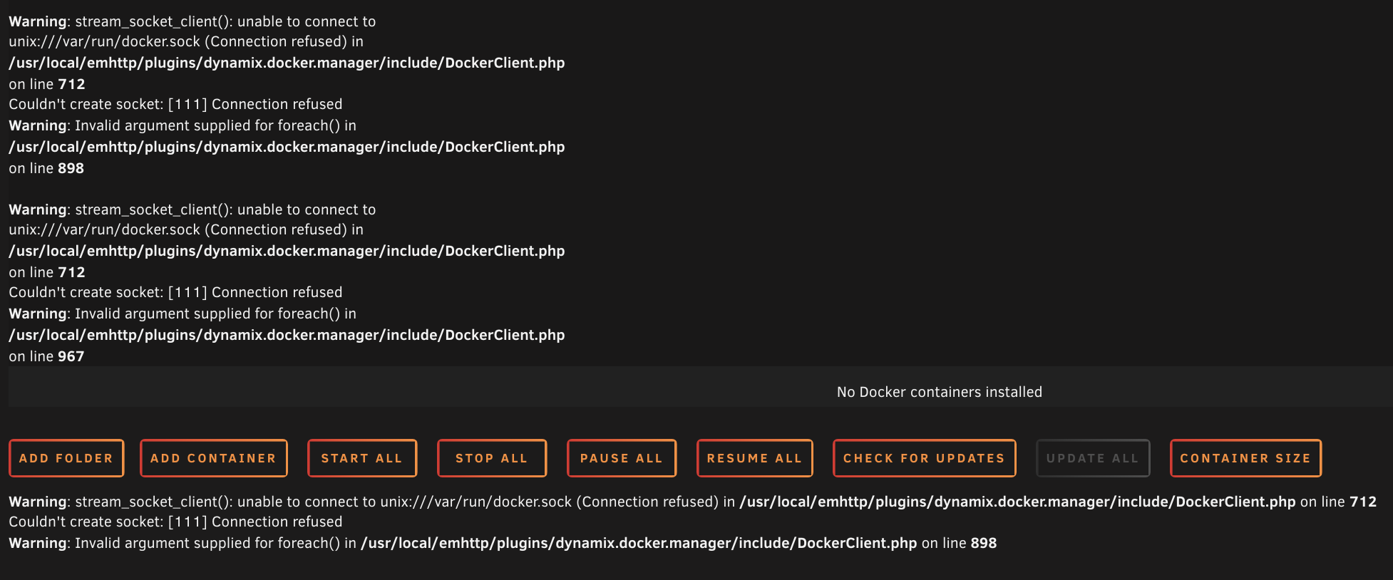

I was just made aware that my server wasn't accessible by a user, I went and took a look and found the attached screenshot of my Docker tab.  I immediately deleted, then recreated my docker image, but that has not changed the status of this page.  I'm currently rebooting my machine to see if that makes a difference, but I'm not sure where to start on this.  I did have a queue of files processing but was using the server less than an hour ago without any indication of a problem.  Diagnostic also attached, any help appreciated.

After the reboot the docker service is started, oddly though with all my apps back to normal.  I would have thought deleting the docker image file would have hosed those.  Most services are running as expected, but I'd still love to find out what happened here if anyone has a clue.
Cache filesystem went read only, that's what caused the problem, if it happens again suggest backing up that fs and re-formatting.
