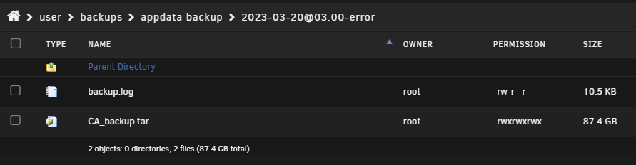

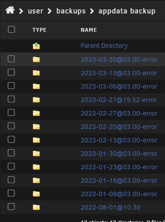

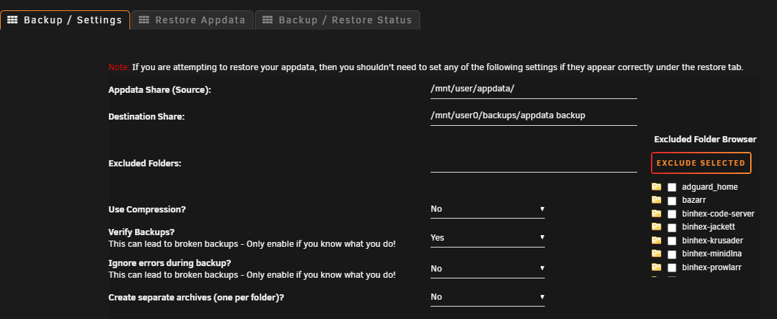

I keep getting an error on my appdata backup (errors below). Tar files are being made, See screenshot 2. When i go to restore my appdata it only allows me to select the non errored backup from 2022-08-01. I assume if i rename the folder it will take but im curious if someone could advise what the error is or how to investigate this? I dont need the backups at the moment, just doing some housekeeping on the server.
